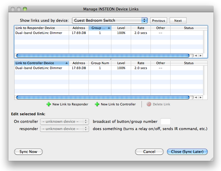

The primary place that you'll manage links between devices is in the Manage INSTEON Device Links dialog. Select Manage INSTEON Device Links from Interfaces→INSTEON/X10 Power Line, and the dialog will popup:

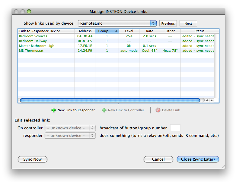

For example, you can use Indigo to remotely program button #1 on a RemoteLinc to: set the thermostat to 68°, brighten the bedroom sconces to 75%, dim the bedroom overhead fixture down to 35%, turn off the hallway and bathroom lights.
Indigo automatically creates the links to define the scene in most remote modules. This means you do not have to press-and-hold the set button or up paddle on most remote modules. Indigo will do it all remotely for you with a single press of the Sync Now button. See the Supports Remote Link Management column of the INSTEON module and Indigo 4 compatibility table for information on which modules Indigo can remotely manage.

- Responder modules respond to incoming INSTEON commands by controlling a load (light or appliance), a thermostat setting, sprinkler valves, low-voltage relays, etc. Examples of responder modules include: LampLinc, ApplianceLinc, and the EZRain sprinkler controller.
- Controller modules send outgoing INSTEON commands onto the power line or via RF to modules that are responders. Examples of controller modules include: RemoteLinc, ControLinc, and the PowerLinc computer interface.
- Some modules are both responders and controllers. For example, a KeypadLinc can respond to a RemoteLinc but it can also control other modules, such as a LampLinc.

- If you want to add a new responder module to the scene, then press the
New Link to Responderbutton. If you want to change the settings (brightness, ramp rate duration, etc.) of an existing responder module in the scene, then select that module's link in the table with theLink to Responder Devicecolumn title. - Choose the button or group number that identifies the scene you are defining in the controller (ex: RemoteLinc button #1) from the
broadcast of button/group numberpopup control. - Choose the responder module's device name from the responder popup control (ex: LampLinc).
- When responding to a scene command, most modules will control the main load (light or appliance) connected to that module. For these modules (SwitchLinc, ToggleLinc, LampLinc, etc.) you can specify the exact brightness you want for that module as well as a duration for how quickly the module should go to that brightness: Some modules will have different options. For example, when a KeypadLinc is responding to a scene command, it can turn one of the secondary button LEDs on instead of controlling the main load, or the thermostat module can respond to a scene command by changing both the thermostat operation mode and the current
coolandheatsetpoint temperatures. - Optionally turn on the
Persistentcheckbox to force this link to automatically be restored whenever either the responder module or controller module is synced. If the modules are ever reset, replaced, or have this link modified, then Indigo will automatically rewrite the original link on the next sync operation. - Repeat steps 1 through 5 for every new responder module that you want to add to the selected controller.

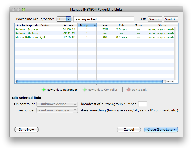

- Choose
Manage INSTEON PowerLinc Links…from theInterfaces→INSTEON/X10 Power Linemenu. - Select a
PowerLinc Group/Scenenumber to use for the scene. Use 1 if this is your first scene. - Optionally enter a
PowerLinc Group/Scenename in the edit field (ex: “reading in bed”).
New Link to Responderbutton. If you want to change the settings (brightness, ramp rate duration, etc.) of an existing responder module in the scene, then select that module's link in the table in the top-half of the window. - Choose the responder module's device name from the
responderpopup control. - When responding to a scene command most modules will control the main load (light or appliance) connected to that module. For these modules (SwitchLinc, ToggleLinc, LampLinc, etc.) you can specify the exact brightness you want for that module as well as a duration for how quickly the module should go to that brightness by using the % text box and the duration popup. Some modules will have different options. For example, when a KeypadLinc is responding to a scene command it can turn one of the secondary button LEDs on instead of controlling the main load, or the thermostat module can respond to a scene command by changing both the thermostat operation mode via the mode popup and the current
coolandheatsetpoint temperatures using the text boxes. - Optionally turn on the
Persistentcheckbox to force this link to automatically be restored whenever the responder module is synced. If the responder module is ever reset, replaced, or has this link modified, then Indigo will automatically rewrite the original link into the device when it is next synced. - Repeat steps 1 through 4 for every new module you want to add to the scene.
Lastly, have Indigo write all of your link changes to both the PowerLinc and the remote modules by pressing the Sync Now button to have Indigo immediately write all changed links to the PowerLinc and remote modules. Or, press the Close (Sync Later) button to close the link editor window and write the changes to the modules at a later time. When you are ready to write the changes to the PowerLinc and remote modules select Start Sync INSTEON Device Links… from the Interfaces→INSTEON/X10 Power Line menu, and then press the press the Sync Changes Only button.
