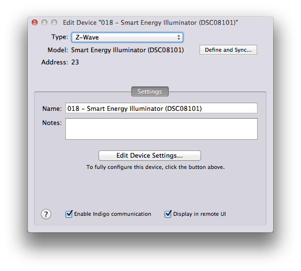

Devices in Indigo are “things” that Indigo can interact with. Not only can Indigo interact with Z-Wave®, INSTEON, and X10 devices but Indigo Pro also supports devices provided by third party plugins. This greatly expands the kind of devices that can be defined in Indigo.
Here is the device dialog:
Device Dialog New Image
The first thing that you need to select is the Type. All versions of Indigo include support for the following device types: Z-Wave, INSTEON, and X10 (click on the types for details of how to manage devices of that type). Indigo Pro will also add a Virtual Devices interface type and will show the following plugins that provide device types (these plugins ship with Indigo 6 Pro):
Device Dialog Z-Wave Image

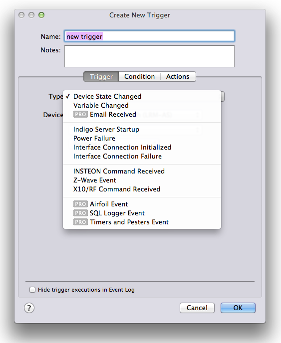

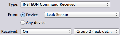

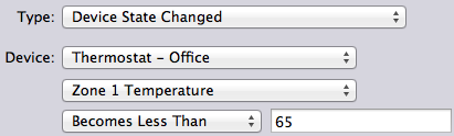

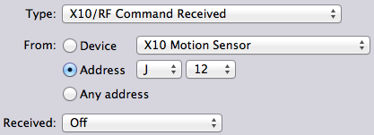

Trigger Dialog Image

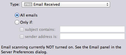

Email Received Trigger Image
Use the Type Z-Wave Command Received to trigger an action when Z-Wave commands are sent from a device, like a scene controller or motion sensor, and then received by the Z-Wave interface. Each device type will have different options based on it's capability
Plugins may define events as well - these will be listed below the X10/RF Command Received event in the Type popup. By default, Indigo Pro includes two plugins that provide events: Airfoil and SQL Logger - click on their links for a description of the events they supply.

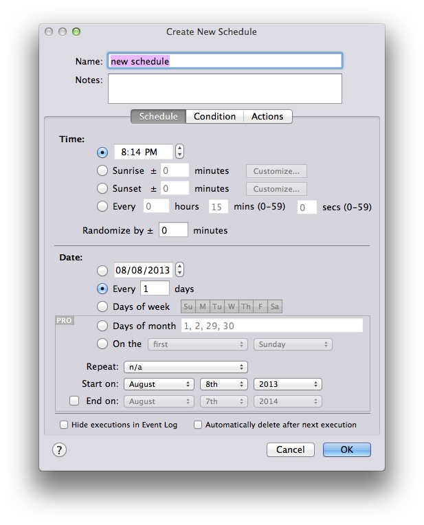

Schedule Dialog Image

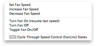

Fan Speed Controls
  • Cycle Through Speed Control (FanLinc) States - use this action to cycle through the fan speeds in this order: High, Medium, Low, Off. It's basically an electronic version of pulling the fan's chain.

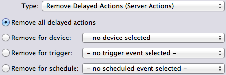

Remove Delayed Actions
Remove Delayed Action Image

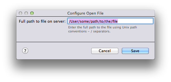

Open File (Pro Only)
Open File Action Image

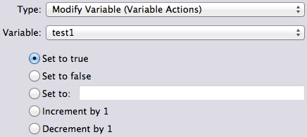

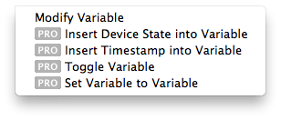

There are three actions that are specific to variables.
Modify Variable
Modify Variable Action Image

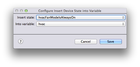

Insert Device State into Variable (Pro Only)
Insert Timestamp into Variable (Pro Only)

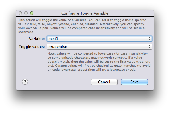

Toggle Variable (Pro Only)
Toggle Variable Action Image

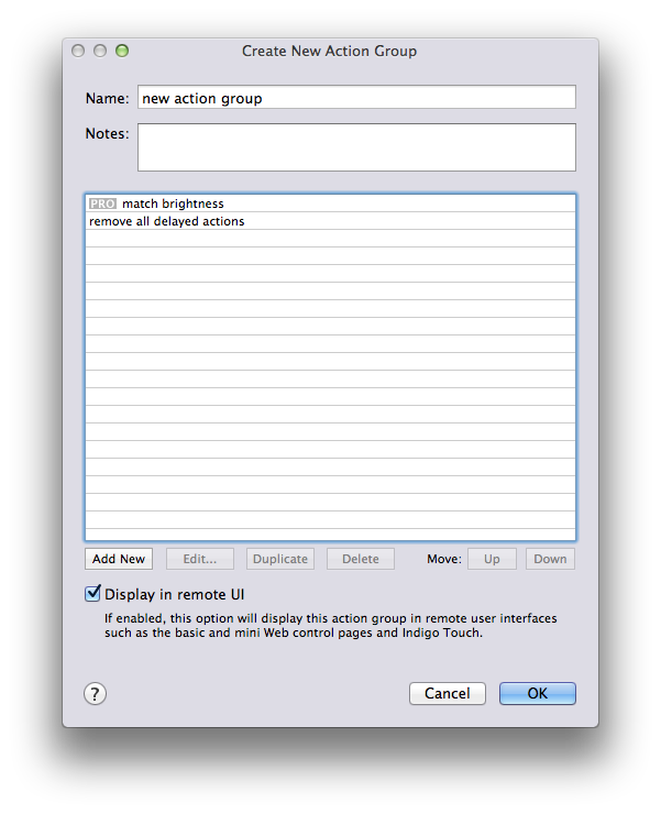

To create a new action group:
Action Group Dialog Image

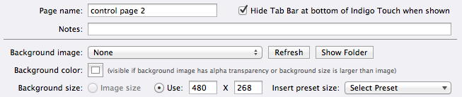

This is where you set global information about the page itself. The Page Name: and Description: fields are pretty self-explanatory. Check the Hide Tab Bar at bottom of Indigo Touch when shown to have the bottom navigation bar hidden when this page is viewed in Indigo Touch. You can use a Background image: by selecting it from the popup, such as a floorplan or other image. You can add your own image by creating a PNG file and adding it to the backgrounds folder (to open that folder in the Finder just click the Show Folder button - and if you add an image while Indigo is running, click the Refresh button to have it added to the popup). Note: some versions of Indigo 6 don't like spaces in the background image name so just replace spaces with another character such as an underscore.

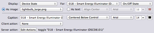

Device State

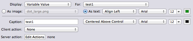

Variable Value

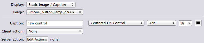

Static Image/Caption

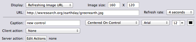

Refreshing Image URL

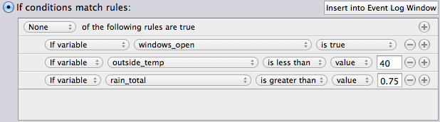

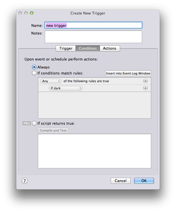

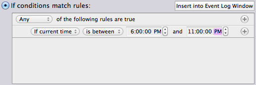

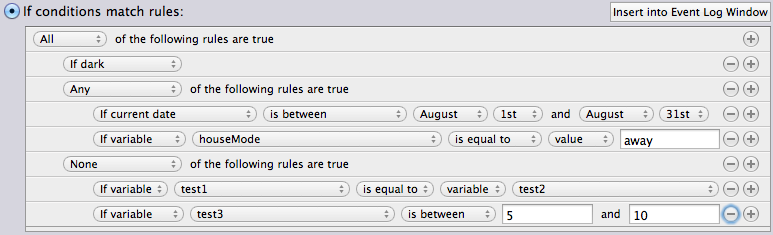

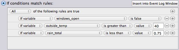

Conditions Tab Image
  2. if it's too cold outside
Sprinkler Condition Image
Complex Condition Rule Image
    "If dark"
