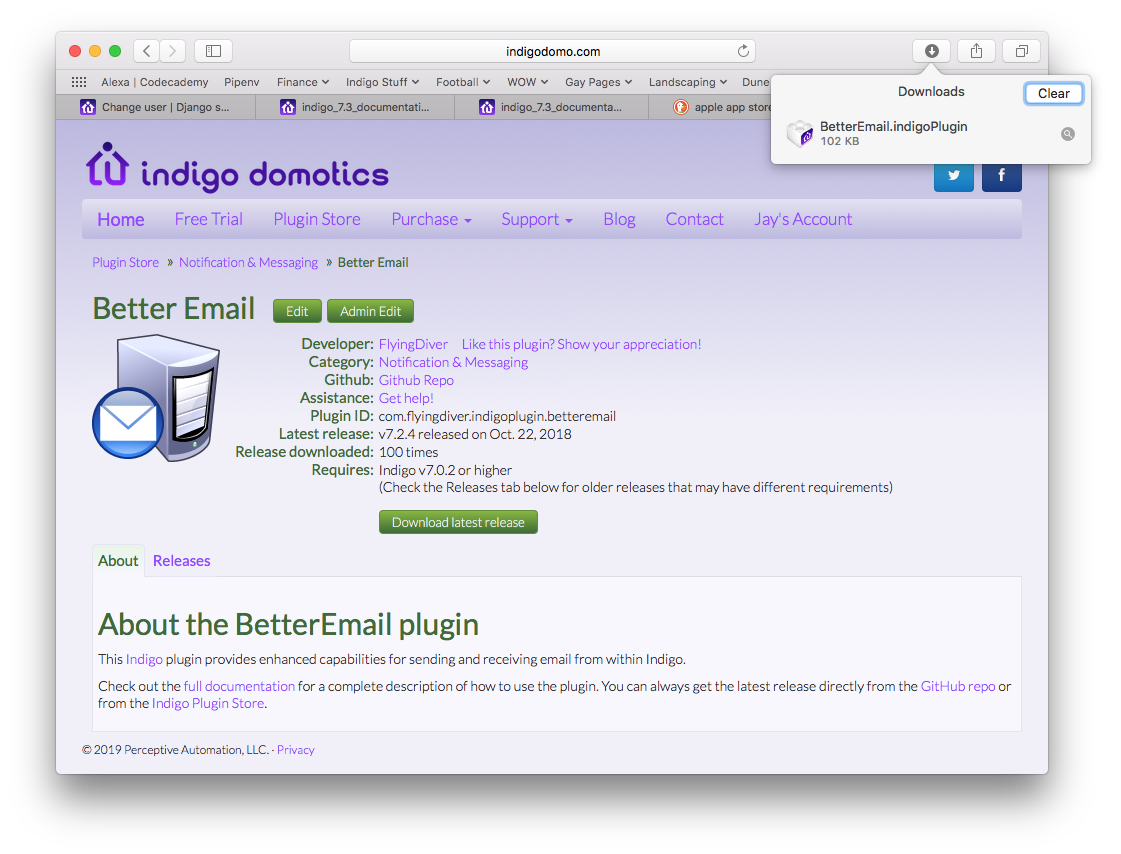

- In Safari on your Indigo Server Mac, go to the Plugin Store and navigate to the Plugin you want to install.
- Make sure that the plugin is supported by Indigo 7.2 (look for the Requires field).
- Click the
Download Latest Releasebutton, which will download the plugin. - When the download is complete, click on the down arrow in the title bar which will show the plugin download.
- Most plugins will show the plugin directly as the above image. If it does, double click it and proceed to step 8 below.
- If you see a folder icon (usually with an odd name) in the download dropdown rather than the plugin icon, double-click on the folder and it'll switch to the Finder with the download folder open.
- In the Finder window that's now showing, you should see the plugin which will end in
.indigoPlugin. Double-click that file. - You will be switched to the Indigo Client app, and you'll a dialog window which asks you if you want to install and enable the plugin
- Click the
Install and Enablebutton. - Done!

Uninstalling a Plugin
- Shut down the Indigo Server by selecting the
Indigo 7.5→Stop Servermenu item in the Mac client (you can leave the client app running). - Open the following folder in the Finder:
/Library/Application Support/Perceptive Automation/Indigo 7.5/(you can select theGo→Go to Folder…menu item in the Finder and paste in the path to open a Finder window). In that Finder window you'll see two folders:PluginsandPlugins (Disabled). Depending on whether the plugin is enabled or not will determine which folder it's in. Open the appropriate folder and delete the unwanted plugin. - Switch back to the Indigo 7.5 Mac client and click on the
Start Local Server…button in theServer Connection Statusdialog.

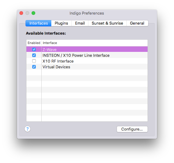

Configuring Email Settings
Typically, ISPs or other email service providers allow multiple email addresses for each customer. We recommend that you create a new email address specifically for Indigo, such as [email protected]. Using a separate email address for Indigo will eliminate the possibility that Indigo might trigger an action from a personal email not intended for Indigo, and will allow you to use the Delete from server options shown below to reduce mailbox clutter.
To configure email sending
- Choose
Indigo 7→Preferences…menu item, then make sure theEmailtab is selected. - Enter your SMTP server address. You probably don't need to change the SMTP server port, but if your server uses SSL (TLS) security, check that checkbox.
- Enter your SMTP username and password (these may be optional)
- If you want the recipient of the email to reply to a different email address than the one you're sending from, enter it in the
Reply-to email addressfield. Note that some SMTP mail servers are configured to not send emails unless the reply-to address specified matches the email address for the account. If mail sending fails, then make sure that the reply-to email address matches the email address for your account.
To configure email scanning
- Choose
Indigo 7→Preferences…menu item, then make sure theEmailtab is selected. - Enter your POP server address, user (also called account) name, and password.
- Select the
Check email everycheckbox. - Enter the time interval to wait between email scans (default 10 minutes).
- Optionally choose
Delete from server emails that trigger actionsto have Indigo automatically remove any email messages that cause Indigo to trigger an action from your mail server. You should only use this option if Indigo has a dedicated email account. - Optionally choose
Delete from server all emailsto have Indigo automatically remove all email messages from your mail server. You should only use this option if Indigo has a dedicated email account.
- Choose
Date & Timeicon. - Select the
- Choose the
Indigo 7.5→Preferences…menu item, then make sure theSunset & Sunrisetab is selected. - Select the
You can configure other Indigo settings by opening the preferences dialog (selecting the Indigo 7→Preferences… menu item) and clicking on the General tab.
