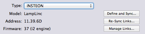

Insteon Device Detail Image

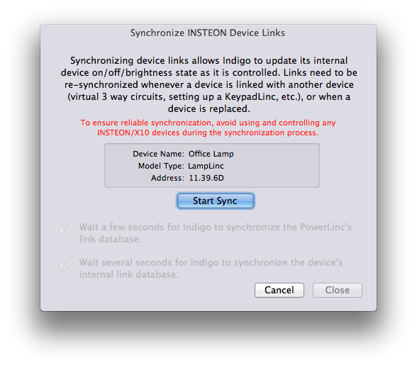

Start Sync Dialog Image
