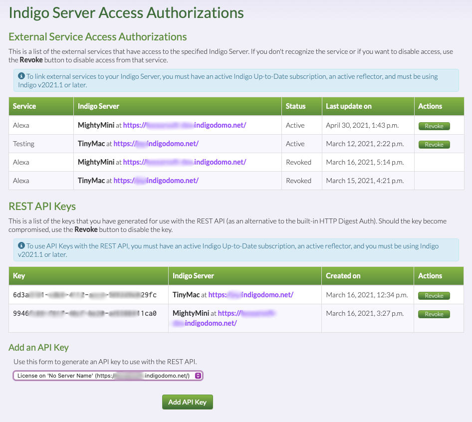

In Indigo 2021.1 or later, you can use an even more secure API token to authenticate your REST requests.
Note: To use API Keys with the REST API, you must have an active Indigo Up-to-Date subscription.
To use keys to authenticate REST calls, you must first generate an API Key in your Indigo Account. Log in and select the Authorizations item in the navigation menu on the left. This will show you a page that looks something like this:
Authorizations Image
The lower section of the page shows your API Keys. You can generate a new key by selecting your license from the popup at the bottom and clicking the Add API Key button. This will generate a key that is valid on the license specified (most users just have a single license, but some have multiple).
Next, when you make a call to the REST API, you will include the Authorization header with the value of 'Bearer API_KEY_HERE'. In curl:
curl -H "Authorization: Bearer API_KEY_HERE" [other options here]
