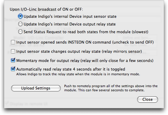

Edit Module Settings_
and select only the following options (click Upload Settings
after you change them)ge them):Update Indigo's internal Device input sensor state
Momentary mode for output relay (relay will only close for a few seconds)
Binary Inputs: 1
and that when the garage door is open, Binary Inputs: 0
