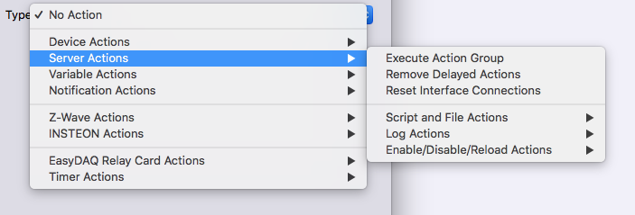

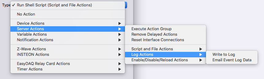

Execute Action Group - executes an Action GroupRemove Delayed Actions - removes delayed actions with the following options:Remove all delayed actions - this will remove all delayed actions regardless of delay typeRemove for device - remove any delays for the selected deviceRemove for trigger - remove any delays from the selected triggerRemove for schedule - remove any delays from the selected scheduleReset Interface Connections - resets the Insteon and X10 RF interfaces
The Execute Script action allows you to execute a Python script as an embedded script or stored in a script file (you may also select an AppleScript script file). In general, you should use embedded scripts for scripts that are short and very quick to execute.
Embedded scripts will be limited to 10 seconds of execution time - if they run longer than that they will be killed. If you have a script that is a long running script you should save it in a separate file and execute it from the file by selecting the File radio button then selecting the file. Scripts executed from files are executed in their own process and are therefore much less likely to adversely affect the server process if they don't work as expected.
Note: if you're running a Python 2.7 script you'll probably just want to use the Execute Script action since script files run from this plugin won't have access to the IOM (import indigo, which is Python-only). You can run Python 3 scripts from this action if you have a Python 3 interpreter installed.
