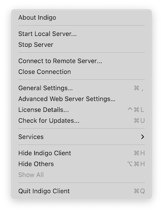

About Indigo 2023.2 - this will show the About window which will show what client and server versions you're running and will show your registration codeStart Local Server… - this will open the Start Server dialogStop Server - this will stop the Indigo ServerConnect to Remote Server… - this option will allow you to connect to a different Indigo server or a server running on another MacClose Connection - this will close the connection to the serverGeneral Settings… - this opens the preferences dialogAdvanced Web Server Settings… - this opens the Indigo Web Server Settings dialogLicense Details… - this opens the Subscription Status window that will show you the status of your License and it's associated Up-to-Date Subscription:
Check for Updates… - this will have the server your connected to contact us to see if there is an update available
