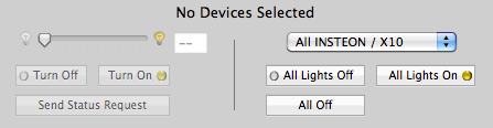

If you have no device selected, only controls that affect collections of devices are shown:

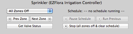

Sprinkler detail allow you to turn on a specific zone, go to the next or previous zone, update the valve status. And, if a schedule is currently running, pause/resume it, begin running the previous schedule, and stop all activity.

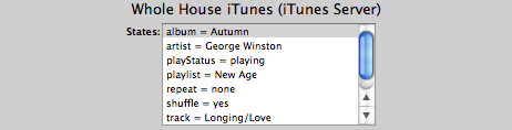

Because plugin devices can define as many states as they like, we've provided a list of all states and values in the detail area for every plugin device.

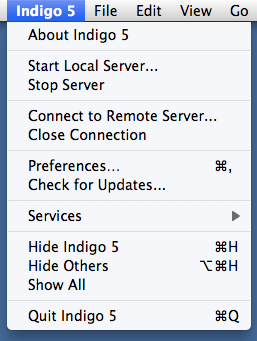

In the Getting Started guide, we visited almost all the tabs on the Indigo Preferences window. We did, however, miss the General tab:
About Indigo 5 - this will show the About window which will show what client and server versions you're running and what your registration code isStart Local Server… - this will open the Start Server dialogStop Server - this will stop the Indigo ServerConnect to Remote Server… - this option will allow you to connect to a different Indigo server or a server running on another MacClose Connection - this will close the connection to the serverPreferences… - this opens the preferences dialogCheck for Updates… - this will have the server your connected to contact us to see if there is an update available

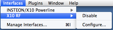

Enable/Disable - toggles the interface on and offConfigure… - opens the configuration preferences for this interfaceUpload Settings… - opens the upload dialogManage INSTEON PowerLinc Links… - opens the PowerLinc link editor windowManage INSTEON Device Links… - opens the device link editor windowStart Sync INSTEON Device Links… - starts any pending link sync operationsStop Sync INSTEON Device Links - stops any ongoing linking operations
