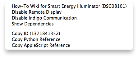

Rename Folder… allows you to rename the folder.Delete Folder will do just that. If the folder isn't empty, it will show you a sheet with 3 options: Cancel (do nothing), Delete Items (delete the items in the folder along with the folder), or Move Items (move the items to the parent first then delete the folder).Disable/Enable Remote Display (for devices, action groups, and control pages) will show/hide it in remote clients (like Indigo Touch for iOS and Web, the DomoPad 3rd party client for Android, etc).Copy ID (123456789) will copy the unique folder ID for use in Python scripts.To move an object to a folder, just drag it from the list view onto the folder (or top-level object) - somewhat like moving mail messages from the inbox to a mail folder in the Mail application.
This menu will:
indigo.devices[91776575] # “Living Room Switch”device named “Living Room Switch” (AppleScript will be deprecated in Indigo 7.4+)Triggers and Schedules have a contextual menu when you right-click on them that will allow you to:

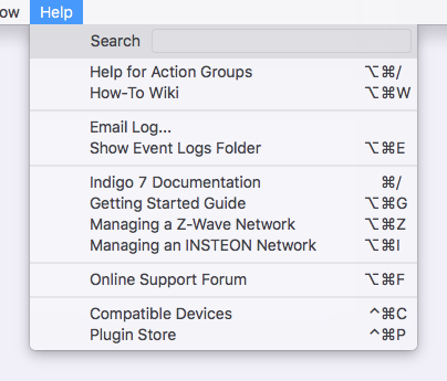

Help for XXXX - this will change slightly based on what window is selected and what's selected in that window - but it will open the default browser to the page in the help documentation for that particular itemHow-To Wiki - this will also change slightly based on what's selected - it will open to the How-To wiki for the selected item (if a device is selected it will go to the wiki for that device, otherwise it will just go to the landing page)Email Log… - this option will email some of your event log data to the specified email address. Particularly useful for technical supportIndigo 7 Documentation - this will open your browser to the landing page for all Indigo 7 documentationGetting Started Guide - this will open your browser to the Getting Started Guide, the place where everyone new to Indigo should startManaging a Z-Wave Network - opens a browser window to the Managing Your Z-Wave Network document in our Documentation wikiManaging an INSTEON Network - opens a browser window to the Managing Your INSTEON Network document in our Documentation wikiOnline Support Forum - this will open your browser to our support forum - it's very active and is the primary place where you should seek help - we answer questions there very quickly and in fact we have many helpful users that can help as wellCompatible Devices - opens a browser window on our new Compatible Devices list that shows which devices and interfaces have been tested with Indigo and includes devices supported by 3rd party pluginsPlugin Store - this will open your browser to our Plugin Store where you can browse and download hundreds of 3rd party plugins that add functionality to IndigoZ-Wave® is a registered trademark of Sigma Designs, Inc. Indigo's support of Z-Wave hardware is neither endorsed nor certified by Sigma Designs.
