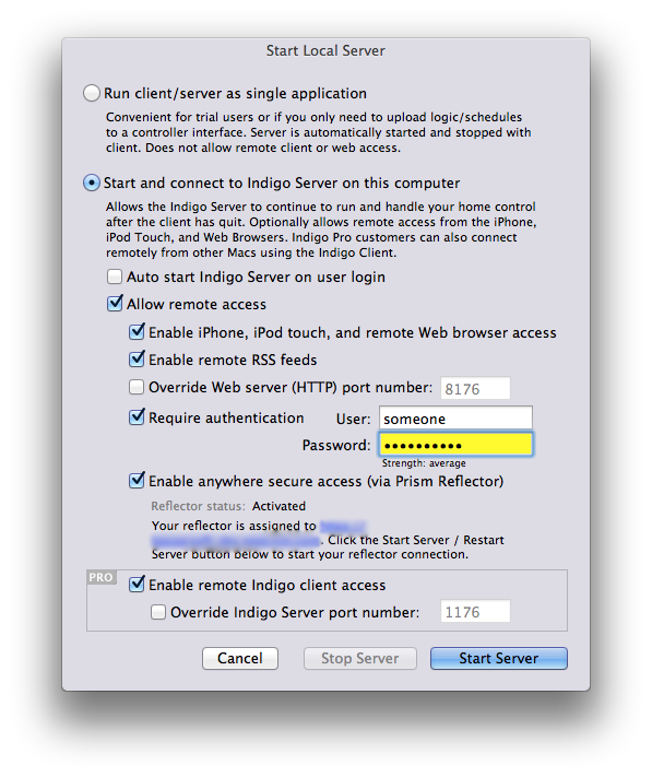

Starting Indigo Server
  1. Double click the Indigo 7.4 application (/Applications/Indigo 7.4.app).
  2. If this is the first time to run Indigo 7 on this Mac, then press the Start Local Server… button in the connection status window.
  3. If you want to reconfigure the Indigo Server on a Mac already running Indigo, then select the Indigo 7.4→Start Local Server… menu item.
Start Server Dialog Image
If you only have one Mac and do not wish to remotely access Indigo from a Web browser, iPhone, or iPod Touch, then you can choose the Run client/server as single application radio button. This will automatically run the client/server as a single application. This requires that the Indigo UI always be running on your Mac - when you quit the Indigo 7.4 Client application (Indigo 7.4→Quit) all Indigo event processing (triggers, schedules, scripts, etc.) will cease processing. This is not our recommended configuration.
NOTE: Indigo Server must be running to use Indigo Touch or to access the Indigo Web Server.
