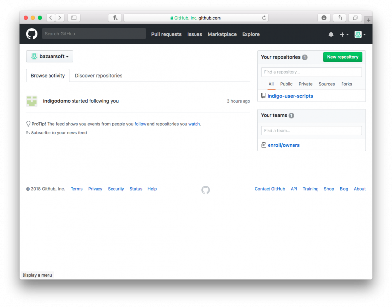

Step 6: Create a release
To manage releases, you need to use the GitHub Website. Log in to your GitHub account and you should now see your new repo in the Your Repositories section to the right:
Click on your repo and you'll go to the repo page:
