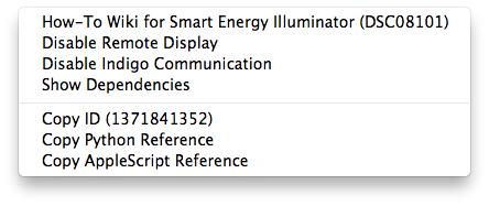

This menu will:
- Take you to the How-To wiki for that device type - if it's a plugin device, it will take you to the help page supplied by the plugin developer.
- Toggle remote display - this tells Indigo whether to show the device in remote clients.
- Toggle communication with the device - this effectively enables/disables the device. If a device is disabled, it will show up gray in the list.
- Open a window that shows all other objects that are dependent on this device. See Deletion Dependencies for more information.
- Copy the unique ID of the device to the clipboard - to assist in writing Python scripts that use the device
- Copy a Python script string that will return an instance of the selected device. It will look like this:
indigo.devices[91776575] # “Living Room Switch”

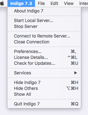

Indigo 2021.1 Menu

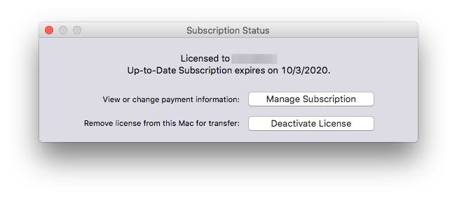

About Indigo 7- this will show the About window which will show what client and server versions you're running and will show your registration codeStart Local Server…- this will open the Start Server dialogStop Server- this will stop the Indigo ServerConnect to Remote Server…- this option will allow you to connect to a different Indigo server or a server running on another MacClose Connection- this will close the connection to the serverPreferences…- this opens the preferences dialogLicense Details…- this opens the Subscription Status window that will show you the status of your License and it's associated Up-to-Date Subscription:

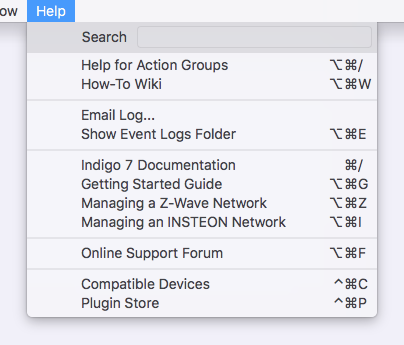

Help Menu
Help for XXXX- this will change slightly based on what window is selected and what's selected in that window - but it will open the default browser to the page in the help documentation for that particular itemHow-To Wiki- this will also change slightly based on what's selected - it will open to the How-To wiki for the selected item (if a device is selected it will go to the wiki for that device, otherwise it will just go to the landing page)Email Log…- this option will email some of your event log data to the specified email address. Particularly useful for technical supportIndigo 7 Documentation- this will open your browser to the landing page for all Indigo 7 documentationGetting Started Guide- this will open your browser to the Getting Started Guide, the place where everyone new to Indigo should startManaging a Z-Wave Network- opens a browser window to the Managing Your Z-Wave Network document in our Documentation wikiManaging an INSTEON Network- opens a browser window to the Managing Your INSTEON Network document in our Documentation wikiOnline Support Forum- this will open your browser to our support forum - it's very active and is the primary place where you should seek help - we answer questions there very quickly and in fact we have many helpful users that can help as wellCompatible Devices- opens a browser window on our new Compatible Devices list that shows which devices and interfaces have been tested with Indigo and includes devices supported by 3rd party pluginsPlugin Store- this will open your browser to our Plugin Store where you can browse and download hundreds of 3rd party plugins that add functionality to Indigo
