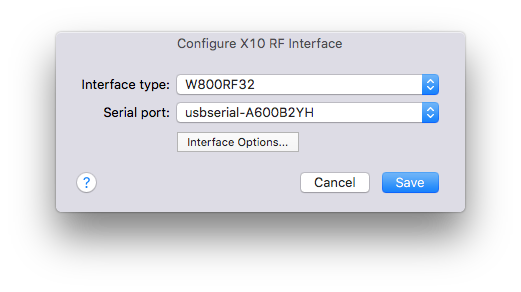

The process for connecting X10 RF Interfaces is basically the same as for power line interfaces - you just need to select the correct serial port. The W800USB will require installing the FTDI drivers mentioned above. You only need to use this interface if you're using a separate X10 RF interface like the W800 or MR26.
X10 RF Configuration Dialog Image

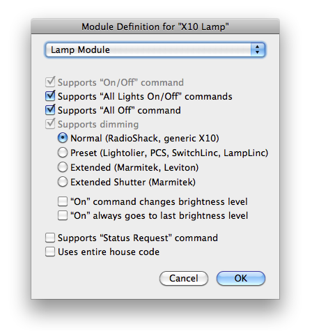

However, you may have a device module not currently listed in the Type popup menu. To use devices that are not defined in the device Type popup, you can click the Definition… button you will be shown the Module Definition dialog:
X10 Definitions Dialog Image
