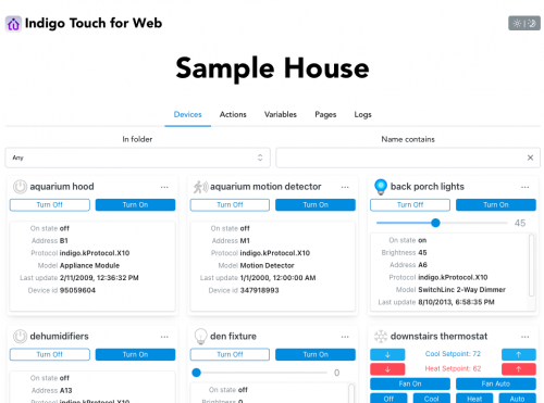

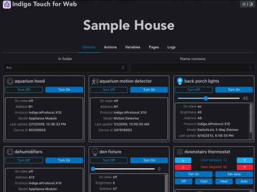

Indigo includes an integrated web server that allows you to serve your own custom content, and it also includes a web-based alternative to Indigo Touch for iOS called Indigo Touch for Web or ITW. ITW is a Single Page Application (SPA) that runs entirely in a browser. ITW is not meant to be a replacement for the Mac Client – you can't configure devices or add variables for example – however, the most common Indigo functions are available. These include turning on/off devices, controlling thermostats, changing variable values and so on. Available features are listed below and we have plans to include more features in the future!
Indigo Touch Web Image
ITW works by establishing a bi-directional connection to the Indigo Websocket API. ITW works on both desktop and mobile (mobile availability depends on configuration and whether you're connected locally via WiFi or remotely via cellular).
