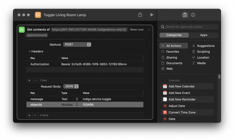

Building your shortcut in the Shortcuts app is largely the same whether you do it on macOS or iOS, and – depending on the type of activity you want to initiate – only takes a couple of steps. The information you'll need depends on what you want to do, but all the API events are constructed in the same way. For this example, we'll use the macOS Shortcuts App to build our shortcut (you can also do it on iOS and iPadOS). At first, this looks like a lot of steps, but there's actually only a few pieces of information required. All values below are entered without quotes. For our first example, we'll perform a simple Indigo Device Toggle.
You'll need:
  • The command you want to execute – such as: indigo.device.toggle,
The Steps
  2. In the search box on the right side, type “Get Contents of URL”.
  5. Click on “Show More”.
  6. Select Method: Post.
  9. Under Key: Authorization.
  16. Under Key: objectId.
At the top of the Shortcut editor window, you can change “Get Contents of URL” to something descriptive like “Toggle Living Room Lamp”. Likewise, you can click on the icon to customize it to your taste. Finally, if you'd like, you can add the Shortcut to your dock (or home screen on iOS), a shortcuts widget, or simply fire them from within the shortcuts app.

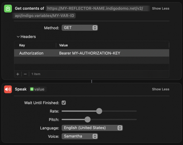

Get a Variable Value
This example shows how to obtain a variable's value and do something with it – in this case, speak the value aloud. The action you take in your shortcut could be any number of things.
Get a Variable Value Image
  • The “trick” to getting the variable's value into the speak action is to tell your shortcut what kind of data it is. To do this, click on Get Contents of URL in the speak action, set the data type to Dictionary, and set Get Value for Key to value (be sure to hit return or tab to get the setting value to stick.)
Get Contents of URL Image
