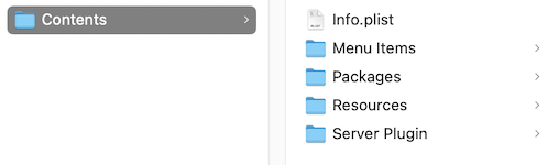

The Indigo Plugin Bundle
We created a macOS Finder bundle type, the Indigo plugin bundle (.indigoPlugin), which has a very specific structure to encapsulate everything that a plugin needs to perform its functions:
The Info.plist File

PluginVersion(Plugin version) - this is the version number for your plugin - it’s shown to the user in the UI and will help you when supporting your plugin users. This key is required and should only contain numerical characters and periods (0-9 and .). For example, “1.0.5.2” is valid, but “1.0.5b2” is not. This is very important as it will help Indigo determine what do to when a user double-clicks a plugin to install it. If the version number is a higher version, Indigo will notify the user that the plugin will be installed and enabled. If the version number is lower than an already-installed version, Indigo will prompt the user to confirm that they want to downgrade the plugin. The version number is also used in version checking, and may eventually be used for automatic updates.ServerApiVersion(Server API version) - this value refers to the minimum server API version your plugin requires. In other words, if your plugin requires server API version 3.0, users must be running Indigo 2022.1.0 or later (the first Indigo version that supports server API version 3.0). Otherwise, Indigo will not allow the plugin to be installed. In rare circumstances, a new server API version may deprecate prior functions, so it's best to review the API Version Chart as new API versions are released.CFBundleDisplayName(Bundle display name) - this is a standard macOS key, and its value represents the name of your plugin. It’s used in a bunch of places in the UI, so make sure that it appropriately identifies your plugin. This key is required.CFBundleName(Bundle name) - this is another standard macOS key, and it's a name that should be less than 16 characters long and be suitable for displaying in menu items with various strings appended (i.e. “ShortName Device Controls”). If it's not provided we'll use the bundle display name instead.CFBundleIdentifier(Bundle identifier) - this is another standard macOS key, and it represents a unique string that represents your plugin. This is used for namespacing where necessary in the code, so it is critical that it is unique. The standard reverse DNS naming scheme is what should be used, although if you aren’t a company you’ll need to figure something out (maybe your blog, etc.). You should limit your bundle id to standard alphanumerics as special/extended characters may cause problems. You should not use thecom.yourorgidentifier.*namespace. This key is required.CFBundleVersion(Bundle version) - another standard macOS key, and it represents the layout of the bundle. This is controlled by us. This key is required.CFBundleURLTypes(URL types) - you must specify one URL that represents a web page where your user can get support. Your plugin will have a menu item called “About [PLUGIN NAME]” - when the user selects this menu item, the default browser will open to this URL. Note - this can be a link to your plugin's Github repo wiki if there is one, or could be a forum topic in the “User Contributions” section of our user forums if you don’t have any other place to host the support page. This key is required.
Menu Items Folder
You can drop Python scripts into this folder and they will show up in your plugin's sub-menu on the new “Plugins” menu. When the user selects the menu item, the script is executed. This is a really simple way of giving your plugin some visible UI.
Resources Folder
This folder is meant to contain any assets (like images, templates, etc.) that your plugin might need.
If there is an icon.png file in here, it will be displayed in the Plugin Store once you submit the plugin (see Plugin Store below for more details). Note that the code that loads config UI XML templates assumes that the Server Plugin folder is the root, so those template files should always be in the Server Plugin tree (i.e., Server Plugin/Templates/my_template.xml).

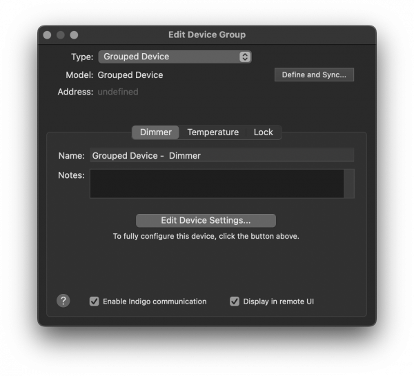

Device Factory
One way to create “multifunction” devices is to use Indigo's Device Factory method. Device Factory devices are defined by using a special %%<DeviceFactory>%% node in Devices.xml. A basic Device Factory device definition would look something like this:
<DeviceFactory> <Name>Device Factory Plugin Device Group</Name> <ButtonTitle>Create</ButtonTitle> <!-- A configUI is required for the device factory element. --> <ConfigUI> <Field id="label" type="label"> <Label>You are not required to have settings here, but a configUI node is required. These will be stored in self.pluginPrefs and will apply to all grouped devices created with the plugin.</Label> </Field> <Field id="name" type="textfield"> <Label>Name:</Label> </Field> </ConfigUI> </DeviceFactory>
<DeviceFactory> <Name>Plugin Device Group</Name> <ButtonTitle>Create</ButtonTitle> <!-- A configUI is required for the device factory element. --> <ConfigUI> <Field id="label" type="label"> <Label>You are not required to have settings here, but a configUI is required. These will be stored in self.pluginPrefs and will apply to all grouped devices created with the plugin.</Label> </Field> <Field id="name" type="textfield"> <Label>Name:</Label> </Field> </ConfigUI> </DeviceFactory> <Device type="dimmer" id="my_dimmer_device" subType="kDimmerDeviceSubType.Dimmer" ui="Dimmer"> <!-- Note that devices can have their own configUIs --> <Name>Example Dimmer Module</Name> <ConfigUI> <Field id="label" type="label"> <Label>You are not required to have a config UI for each individual device, however, creating a settings UI allows for settings that apply only to that group (when more than one grouped device is desired). These will be stored in dev.pluginProps.</Label> </Field> <Field id="name" type="textfield" hidden="false"> <Label>Name:</Label> </Field> <Field id="setting" type="textfield" hidden="false"> <Label>Setting:</Label> </Field> </ConfigUI> <States> <State id="state"> <ValueType>String</ValueType> <TriggerLabel>State</TriggerLabel> <ControlPageLabel>State</ControlPageLabel> </State> </States> </Device> <Device type="sensor" id="my_sensor_device" subType="kSensorDeviceSubType.Temperature" ui="Outdoor Temperature"> <Name>Example Adjustable Sensor Module</Name> <States> <State id="state"> <ValueType>String</ValueType> <TriggerLabel>State</TriggerLabel> <ControlPageLabel>State</ControlPageLabel> </State> </States> </Device> <Device type="relay" id="my_lock_device" subType="kRelayDeviceSubType.Lock" ui="Lock"> <Name>Example Lock Module</Name> <States> <State id="state"> <ValueType>String</ValueType> <TriggerLabel>State</TriggerLabel> <ControlPageLabel>State</ControlPageLabel> </State> </States> </Device>
def create_the_device_group(self, my_name): """ Convenience method for device creation. This could also be done in closed_device_factory_ui() for example. Note that some device props are read only even when you create them from scratch (i.e., dev.version) and some will be ignored if you try to set them (i.e., dev.description, dev.errorState). Note that `protocol`, `name` and `deviceTypeId` are all required with the `indigo.device.create()` method call. """ self.debugLog("create_the_device_group called") # Create the first device in the group. Note that the ''deviceTypeId'' value matches the ''id'' we used in our ''Devices.xml'' definition. new_dev = indigo.device.create(protocol=indigo.kProtocol.Plugin, name=my_name, deviceTypeId="my_dimmer_device") new_dev.model = "Grouped Device" new_dev.subModel = "Dimmer" new_dev.name = f"{my_name} Dimmer" new_dev.replaceOnServer() # Add the group my_name setting to the props of device 1 for later use. new_props = new_dev.pluginProps new_props['name'] = my_name new_dev.replacePluginPropsOnServer(new_props) # Create the second device in the group. You can also add a state value here if desired. new_dev = indigo.device.create(protocol=indigo.kProtocol.Plugin, name=my_name, deviceTypeId="my_sensor_device") new_dev.model = "Grouped Device" new_dev.subModel = "Temperature" new_dev.name = f"{my_name} Temperature" new_dev.replaceOnServer() new_dev.updateStateOnServer('state', value="Some value.") # You can also create devices that don't have corresponding device parameters established in Devices.xml. new_dev = indigo.device.create(protocol=indigo.kProtocol.Plugin, name=my_name, deviceTypeId="my_lock_device") new_dev.model = "Grouped Device" new_dev.subModel = "Lock" new_dev.name = f"{my_name} Lock" new_dev.replaceOnServer()
