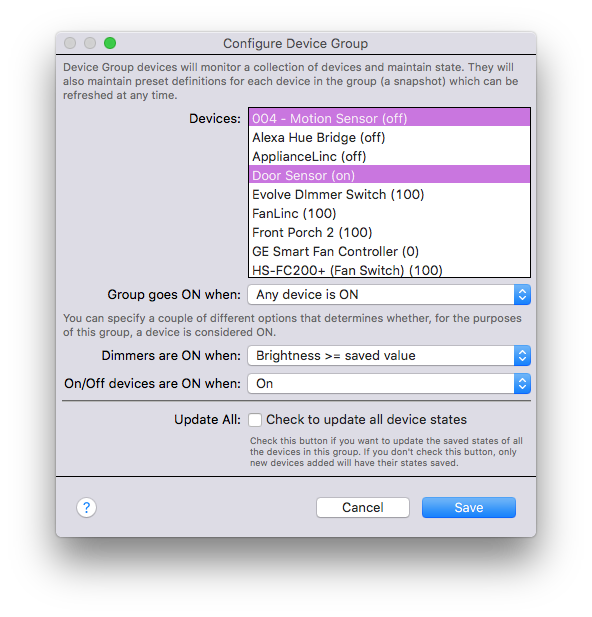

Indigo provides a Virtual Devices Interface type that provides users with several new device types, each discussed below. If you want to use Virtual Devices, make sure to enable them by selecting the Interfaces→Virtual Devices→Enable menu item.
Execution Models
Action Groups
Automatic State Maintenance
Scripting State Maintenance
