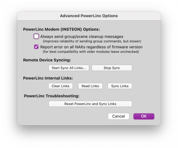

  1. Choose Indigo 2025.2→Preferences… menu, then make sure the Interfaces tab is selected.
If you click on the Interface Options… button, you'll see something like this:
