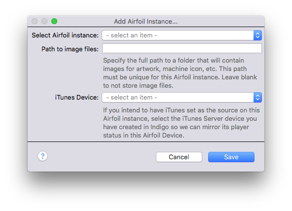

To create an Airfoil Instance device, click the New… button above the devices list. In the resulting Create New Device dialog, select Airfoil Pro as the type and you will see the Add Airfoil Instance… dialog:
albumArt.png- an image of the currently playing album track if the source supports it (notably, iTunes)machineIcon.png- an icon representing the computer that is running this instance of AirfoilmachineIconAndScreenshot.png- a screenshot from the host computer with the machine icon overlaid (though this functionality seems to be missing in Airfoil versions through v5.1.0 - you just get the same image as the machine icon)sourceIcon.png- an icon representing the selected audio source in Airfoil.
When you click the “Save” button, the plugin will create your Airfoil Instance device, and it will query Airfoil and get all it's known speakers. It will then create devices for each of those speakers (see the next section for details on those devices).

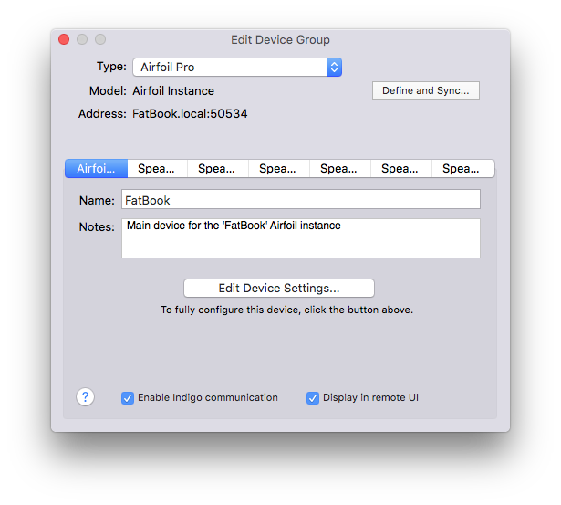

Airfoil instances are actually a group of devices: the instance itself (the first tab), and then multiple speaker devices, one for each speaker device that your instance knows about. We set the name of the Airfoil Instance to the Airfoil name. For each speaker, we name the speaker with this pattern: “Speaker Name (Airfoil Instance Name speaker)” to help you see how the devices relate to each other. We also add a note to each speaker device with a bit more detail about its relationship to its parent Airfoil Instance device.

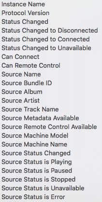

Warning: due to changes that Apple has made to their API, the Source Status Is Playing trigger will no longer fire. This trigger option will be adjusted in a future release.
