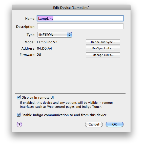

Insteon Device Detail Image
Insteon Dialog Image

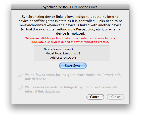

If the sync process fails or does not complete, then make sure that the device is correctly wired or plugged in, both Access Point RFs are installed and on opposite power legs, and that you do not have an uninterruptible power supply (UPS) or surge protector strip plugged into the outlet the PowerLinc is using. If syncing still fails and the device is portable (ApplianceLinc or LampLinc), then try plugging it directly into the pass through outlet on the PowerLinc. See our website troubleshooting tips for additional help.
The Re-Sync Links… dialog will open the Synchronize INSTEON Device Links dialog:
Start Sync Dialog Image
The last button, Manage Links… is how Indigo allows you to remotely manage INSTEON links (without having to walk around pressing set buttons, etc.) and is discussed in great detail on the Indigo INSTEON Link Management page.

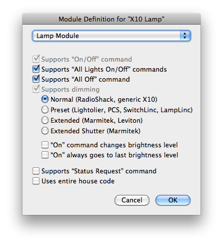

However, you may have a device module not currently listed in the Type popup menu. To use devices that are not defined in the device Type popup, you can click the Definition… button you will be shown the Module Definition dialog:
X10 Definitions Dialog Image

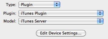

Plugin Device Detail Image
Along with built-in INSTEON and X10 devices, Indigo ships with plugins that allow you to define iTunes Music servers, EasyDAQ relay boards, and NOAA Weather Stations, etc. Each of these new device types define a set of “states” that you can use in other places: for instance, the iTunes Server device has states that represent the player state (playing, paused, etc), the current album, artist, and track, etc. The EasyDAQ plugin allows you to specify the specific board you have and the state of each relay/DIO.

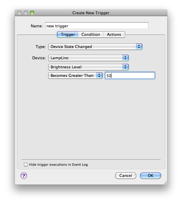

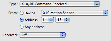

Trigger Dialog Image
Inseton Command Received Trigger Image

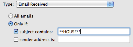

Email Received Trigger Image
Plugins may define events - use the Type Plugin then select the Plugin and the Event to configure the event further.

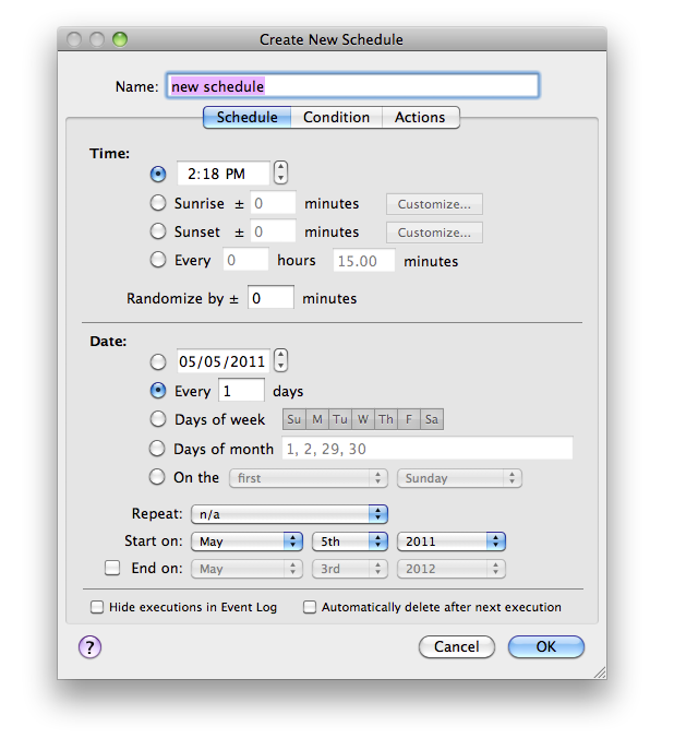

Schedule Dialog Image
  • Every X hours Y minutes - this is the typical repeating setting. TIP: you can use fractional minutes if you like (i.e. .5 is every 30 seconds, .25 is every 15 seconds, etc)

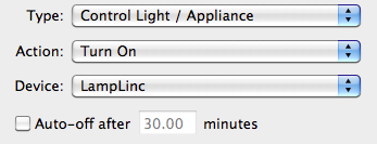

Control Light / Appliance
Control Light Action Image
This action will allow you to control a light (dimmer) or appliance (relay) device. There are 13 possible actions, some of which aren't available for every light or appliance device:

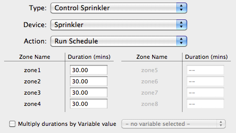

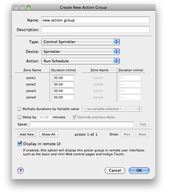

Control Sprinkler (Pro Only)
Sprinkler Action Image
There are seven actions available once you've selected your sprinkler device:
  • Run Schedule - selecting this action will show you the zone table (shown above) that will allow you to set the duration for each zone and optionally multiply those durations by the selected variable. This last option is useful if you change durations based on time of year - you can change the variable value but keep the existing schedule and it'll adjust the duration as appropriate.

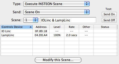

Execute INSTEON Scene
Insteon Scene Action Image
Finally, if you need to add, modify, or delete a device from the scene, click on the Modify Scene… button. See the Indigo and INSTEON Link Management page for more details.

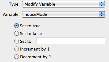

Modify Variable
Modify Variable Action Image

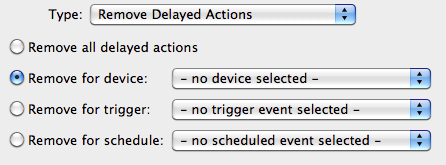

Remove Delayed Actions
Remove Delayed Action Image

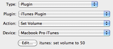

Plugin (Pro Only)
Plugin Action Image
For plugin actions, you specify the Plugin: and Action:. If the action requires a device to be selected, you'll be shown the Device: popup and if there is further configuration for the action you'll see an Edit… button. Click on that button and follow the instructions for that specific action.

To create a new action group:
  4. Optionally give the group a Description.
  5. Select the action Type: and select the various options. (See the actions section above for details on all of the action's settings, and information on how to add additional actions to the Action Group)
Action Group Dialog Image

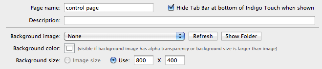

Control pages are custom graphical pages that you can use to control Indigo, either through the browser or Indigo Touch. You design the page - from the background image and/or color to the placement of text labels, control images, and what actions clicking/tapping on those images performs.
Control Page Editor Image
Page Element Examples Image
This is where you set global information about the page itself. The Page Name: and Description: fields are pretty self-explanatory. Check the Hide Tab Bar at bottom of Indigo Touch when shown to have the bottom navigation bar hidden when this page is viewed in Indigo Touch. You can use a Background image: by selecting it from the popup, such as a floorplan or other image. You can add your own image by creating a PNG file and adding it to the backgrounds folder (to open that folder in the Finder just click the Show Folder button - and if you add an image while Indigo is running, click the Refresh button to have it added to the popup).

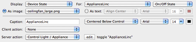

Device State

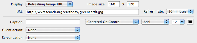

Refreshing Image URL

Client Actions
  1. Popup UI Controls - this will cause the client to pop up a dialog with the controls appropriate for the device or variable selected (it doesn't do anything for other page element types)
  2. Link to Control Page - this will cause the client to display the selected control page so it's useful to navigate between control pages. The Open in new window checkbox really only effects viewing pages in a browser, not Indigo Touch
  3. Link to URL - this will cause the client to open the provided URL in a browser window (a new browser window if the Open in new window checkbox is checked).In Indigo Touch, it will cause Mobile Safari to open and show the page specified by the URL.
Server Actions

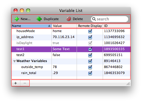

Variables are used to hold information that can help your home automation logic. For instance, Indigo ships with an AppleScript which stores weather information in variables. You can use that information to display on control pages, as part of your conditional logic (see Conditions below), or as a trigger for some other action.
Variable Window Image
If you right-click a variable, you can toggle the Remote Display attribute or copy the variable id to the clipboard (for easy pasting into scripts).

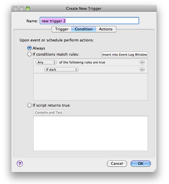

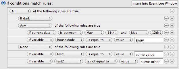

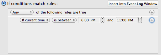

Conditions Tab Image

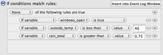

  2. if it's too cold outside
Let's assume that you have a script running that populates Indigo variables with data from a weather station: “rain_total” holds the rain total for the last 24 hours, and “outside_temp” holds the temperature in Fahrenheit. Further, let's say you have a variable, “windows_open”, that's either true or false indicating whether the windows in your house are open or not.
Sprinkler Condition Image
Complex Condition Rule Image
All of the following rules are true
	If variable windows_open is false
	If variable outside_temp is greater than value "40"
	If variable rain_total is less than value "0.75"
