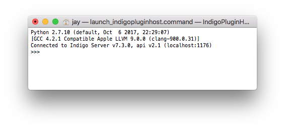

/usr/local/indigo/indigo-host
Connecting Remotely over SSH
ssh username@indigo_mac_ipaddr -t /usr/local/indigo-host
What Else Can it Do?
indigo-host -e '
