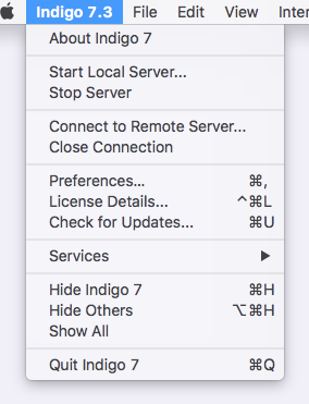

Indigo 7 Menu Image
  • About Indigo 7 - this will show the About window which will show what client and server versions you're running and will show your registration code
  • Start Local Server… - this will open the Start Server dialog
  • Connect to Remote Server… - this option will allow you to connect to a different Indigo server or a server running on another Mac
  • Preferences… - this opens the preferences dialog

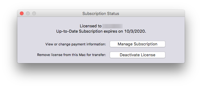

  • License Details… - this opens the Subscription Status window that will show you the status of your License and it's associated Up-to-Date Subscription:
Subscription Status Image
  • Check for Updates… - this will have the server your connected to contact us to see if there is an update available
