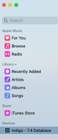

If you're using the Music app (macOS Catalina 10.15.2 or above) that replaced iTunes, you'll see a line in the outline view on the left under Devices named “Indigo - [YOUR DATABASE NAME HERE]”. Select that item.
Music Outline View Image
