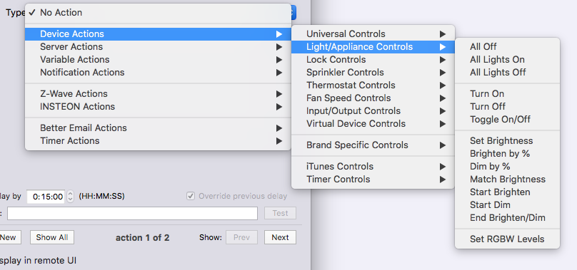

All Off - turn off all light and appliance devices. The Devices: popup lets you select All INSTEON/X10, All INSTEON, All X10, or a specific X10 house code.All Lights On - turn on all light devices with the same Devices: options as All OffAll Lights Off - turn off all light devices with the same Devices: options as All OffTurn On - turn on a specific device with an optional complementary Auto-off after X minutes actionTurn Off - turn of a specific device with an optional complementary Auto-on after X minutes actionToggle On/Off - turn on the device if it's off or off if it's onSet Brightness - set the brightness of a lamp device to a specific percentage (from 0-100)Brighten by % - increase the brightness of a lamp device by a specific percentage (from 0-100)Dim by % - increase the brightness of a lamp device by a specific percentage (from 0-100)Match Brightness - set the brightness of any number of dimmer devices to the value of the selected dimmer device - so you can quickly and easily create a very simple scene.Start Brighten - for Insteon and Z-Wave dimmers, start to brighten the load (using the device's specific ramp rate). You can pair this with an End Brighten/Dim command or you can just allow it to brighten all the way to 100%.Start Dim - for Insteon and Z-Wave dimmers, start to dim the load (using the device's specific ramp rate). You can pair this with an End Brighten/Dim command or you can just allow it to dim until it's finished. Insteon devices will end up at 0% (off), but some Z-Wave devices may stop at 1% rather than being completely off.End Brighten/Dim - for Insteon and Z-Wave dimmers, end a previously issued Start Brighten or Start Dim and update the brightness of the device in Indigo at whatever level the dimmer was at when it stopped.Set RGBW Levels - set the RGBW levels for lights that support setting their color.

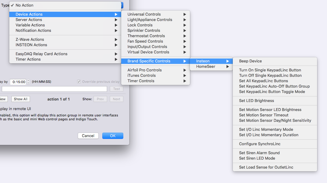

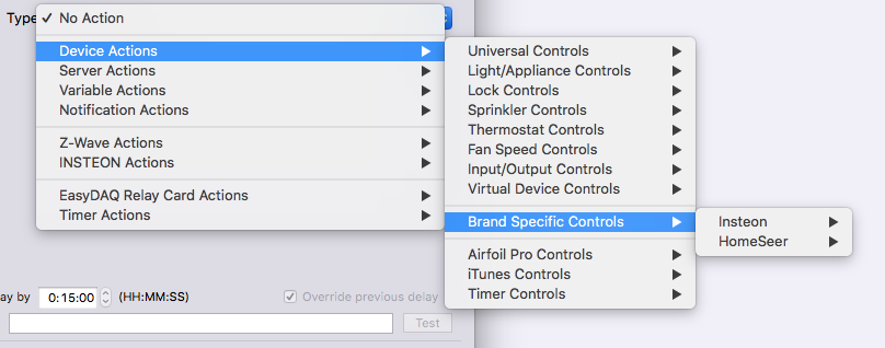

Beep Device - ask the device to beep. This function is dependent on the capabilities of the device.Turn On Single KeypadLinc Button - turn on one individual KeypadLinc button.Turn On Single KeypadLinc Button - turn off one individual KeypadLinc button.Set All KeypadLinc Buttons - turn on/off groups of buttons. Why not just have multiple actions using the built-in Turn ON/Turn OFF LED actions? Because each of those requires a lot of INSTEON traffic - and if you need to set several buttons at once this action will do it in one (or two if you want to maintain some buttons) action(s). It's more efficient and easier to configure (one action versus potentially seven actions). Select the action you want to take for each button: Turn On, Turn Off, Leave Alone. The latter option will require that we query the KPL to find the states first so if you select that for any of the buttons the action may execute a bit slower than it would otherwise. Note: using this action, which is sending raw INSTEON commands through the IndigoServer, will cause the KeypadLinc's button states in Indigo to become out of sync. This is because the server doesn't know that you're changing the button states given that it's just a raw command message that it's being asked to send to the PowerLinc. If you need to keep the states in sync then add another action to do a status request to the KeypadLinc (after a short delay to avoid collisions).Set KeypadLinc Auto-Off Button Group - specify what buttons will go off automatically when you press any other button. Useful in conjunction with Toggle Mode below for creating “radio groups”. See the FanLinc and KeypadLinc article for usage examples.Set KeypadLinc Button Toggle Mode - specify whether a button toggles (alternates between ON and OFF when pressed) or whether it sends a single command anytime it's pressed (can send either ON or OFF). Useful in conjunction with Auto-Off groups above for creating “radio groups”. See the FanLinc and KeypadLinc article for usage examples.Set LED Brightness - set the brightness of the LEDs on certain devices. Newer KeypadLincs are supported as well as some SwitchLinc models. Unfortunately there isn't really a way to tell you which devices are supported so you'll just have to try it and see if it works.Set Motion Sensor LED Brightness - set the brightness of the LED that flashes inside the motion sensor when motion is detected. While the brightness value is between 0 and 255, 0 does not mean the LED is completely off - it's just very dim. Note: only revision 2 Motion Sensors with jumper 5 set can be configured.Set Motion Sensor Timeout - set the timeout value between the time the motion sensor stops detecting motion and when it sends the OFF command. The timeout values work like this: 0 is equal to 30 seconds and 255 is equal to 2 hours. Values in between are proportional to those values. Note: only revision 2 Motion Sensors with jumper 5 set can be configured.Set Motion Sensor Day/Night Sensitivity - set the sensitivity for when the motion sensor detects changes from dawn to dusk and vice versa. The sensitivity values work like this: 0 will make the sensor register day all the time and 255 is equal to night all the time. Values in between are proportional to those values. Note: only revision 2 Motion Sensors with jumper 5 set can be configured and Motion Sensor II models will interpret 0 as 3.Set I/O Linc Momentary Mode - set the momentary mode of an I/O Linc to A, B, C, or None (the built-in UI only sets A or None).Set I/O Linc Momentary Duration - set the duration the output will be on before it automatically goes off (if momentary mode is turned on with the above command).Configure SynchroLinc - configure the Trigger Watts, Threshold Watts, and Delay Seconds in a SynchroLinc. Here are the details of those settings:Set Siren Alarm Sound - configure the sound that will be played the next time the alarm is activated. Choose between chime (doorbell) or siren (loud). The sound will change if this action is called while the siren is sounding.Set Siren LED Mode - configure what the LED on the siren does. Choices are: On Solid, Blink on Insteon Traffic, OffSet Load Sense for OutletLinc - configure the load sense on either outlet in the OutletLinc (dual outlet only)The HomeSeer 200+ series of devices (WD200+, WS200+, FC200+, and HSM200 as of this release) allow the various LEDs on those devices to be controlled in a variety of ways. These actions enable controlling those features.

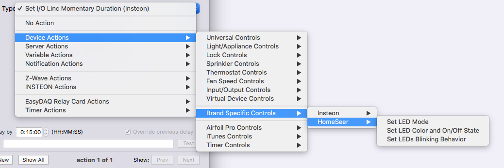

Set LED Mode - set the mode of the LEDs on the switch. The default Normal (load status) behavior is for them to represent the brightness to which the switch is set. You can set the switch to Status (custom status) which will allow you to individually turn on and off each LED and set it's color. You can also set the bottom LED's behavior.Set LED Color and On/Off State - when the switch is in Status mode, you can use this action to turn on/off and set the color of any of the LEDs.Set LEDs Blinking Behavior - start/stop LEDs from blinking.

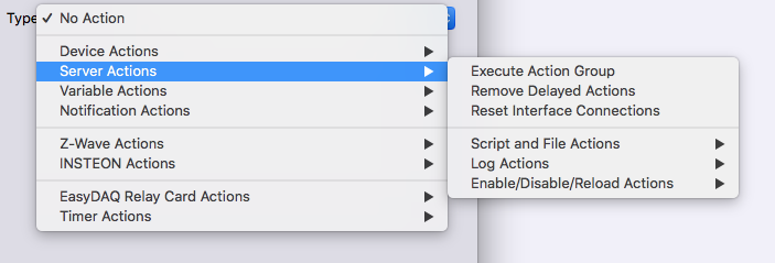

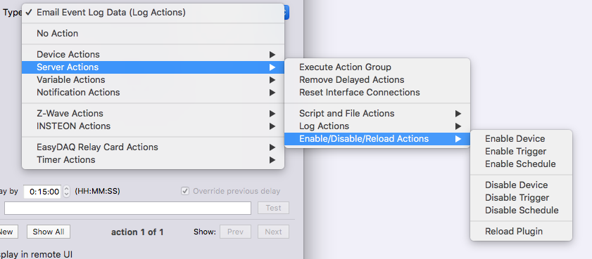

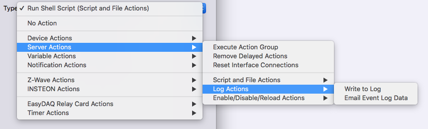

Execute Action Group - executes an Action GroupRemove Delayed Actions - removes delayed actions with the following options:Remove all delayed actions - this will remove all delayed actions regardless of delay typeRemove for device - remove any delays for the selected deviceRemove for trigger - remove any delays from the selected triggerRemove for schedule - remove any delays from the selected scheduleReset Interface Connections - resets the Insteon and X10 RF interfaces

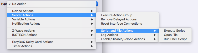

The Execute Script action allows you to execute either a Python or AppleScript (AppleScript will be deprecated in Indigo 7.4+) as an embedded script or stored in a script file. In general, you should use embedded scripts for scripts that are short and very quick to execute.
Embedded Python scripts will be limited to 10 seconds of execution time - if they run longer than that they will be killed. If you have a Python script that is a long running script you should save it in a separate file and execute it from the file by selecting the File radio button then selecting the file. Python scripts executed from files are executed in their own process and are therefore much less likely to adversely effect the server process if they don't work as expected.
Embedded AppleScripts must run on the server's main execution thread so if it delays, can hang on external events like network access, or otherwise does a lot of processing, then everything else in the server will be put on hold until the script is finished. Therefore, you definitely should keep embedded AppleScripts very simple. As with Python scripts, long running AppleScripts should be stored in a separate AppleScript file (created with Script Editor) and executed that way - external AppleScript files execute in their own process and are therefore much less likely to adversely effect the server process if they don't work as expected.
This will run the specified script file optionally with the output being inserted into the specified variable. The script must be marked executable and a valid shebang (#!/path/to/shell) must be specified at the top of the script. Note: if you're running a Python script you'll probably just want to use the Execute Script action since script files run from this plugin won't have access to the IOM (import indigo, which is Python-only).
This action will restart the specified plugin. You must know the ID of the plugin: you can find the ID in a plug's detail page in the Plugin Store.

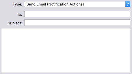

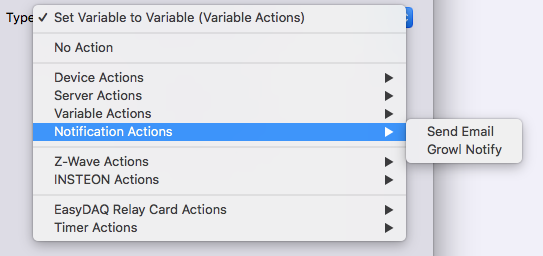

In the standard install of Indigo, there are two actions: Send Email and Growl Notify. Plugins are allowed to add menu items to this category so there may be more options if you've installed some 3rd party plugins.
