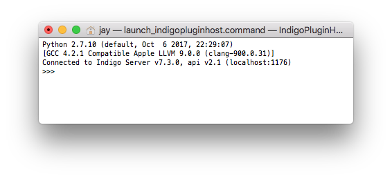

Starting the host from an existing terminal window
If you already have a Terminal shell running, you can launch it directly. To start the IPH in interactive mode just execute the following inside the Terminal:
/usr/local/indigo/indigo-host
As shown, the IPH will automatically connect to the IndigoServer running on the same Mac and will show the server's version information. Additionally, you'll notice that Indigo Server logs the connection of the interactive shell plugin. Add /usr/local/indigo/ to the PATH in your shell (in ~/.bashrc) and you won't have to specify the full path.

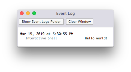

Next, let's tell the Indigo Server to log a message to the Event Log window (again, via the Terminal application):
indigo.server.log("Hello world!")
