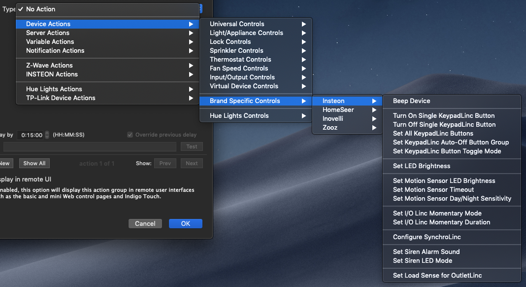

Beep Device - ask the device to beep. This function is dependent on the capabilities of the device.Turn On Single KeypadLinc Button - turn on one individual KeypadLinc button.Turn On Single KeypadLinc Button - turn off one individual KeypadLinc button.Set All KeypadLinc Buttons - turn on/off groups of buttons. Why not just have multiple actions using the built-in Turn ON/Turn OFF LED actions? Because each of those requires a lot of INSTEON traffic - and if you need to set several buttons at once this action will do it in one (or two if you want to maintain some buttons) action(s). It's more efficient and easier to configure (one action versus potentially seven actions). Select the action you want to take for each button: Turn On, Turn Off, Leave Alone. The latter option will require that we query the KPL to find the states first so if you select that for any of the buttons the action may execute a bit slower than it would otherwise. Note: using this action, which is sending raw INSTEON commands through the IndigoServer, will cause the KeypadLinc's button states in Indigo to become out of sync. This is because the server doesn't know that you're changing the button states given that it's just a raw command message that it's being asked to send to the PowerLinc. If you need to keep the states in sync then add another action to do a status request to the KeypadLinc (after a short delay to avoid collisions).Set KeypadLinc Auto-Off Button Group - specify what buttons will go off automatically when you press any other button. Useful in conjunction with Toggle Mode below for creating “radio groups”. See the FanLinc and KeypadLinc article for usage examples.Set KeypadLinc Button Toggle Mode - specify whether a button toggles (alternates between ON and OFF when pressed) or whether it sends a single command anytime it's pressed (can send either ON or OFF). Useful in conjunction with Auto-Off groups above for creating “radio groups”. See the FanLinc and KeypadLinc article for usage examples.Set LED Brightness - set the brightness of the LEDs on certain devices. Newer KeypadLincs are supported as well as some SwitchLinc models. Unfortunately there isn't really a way to tell you which devices are supported so you'll just have to try it and see if it works.Set Motion Sensor LED Brightness - set the brightness of the LED that flashes inside the motion sensor when motion is detected. While the brightness value is between 0 and 255, 0 does not mean the LED is completely off - it's just very dim. Note: only revision 2 Motion Sensors with jumper 5 set can be configured.Set Motion Sensor Timeout - set the timeout value between the time the motion sensor stops detecting motion and when it sends the OFF command. The timeout values work like this: 0 is equal to 30 seconds and 255 is equal to 2 hours. Values in between are proportional to those values. Note: only revision 2 Motion Sensors with jumper 5 set can be configured.Set Motion Sensor Day/Night Sensitivity - set the sensitivity for when the motion sensor detects changes from dawn to dusk and vice versa. The sensitivity values work like this: 0 will make the sensor register day all the time and 255 is equal to night all the time. Values in between are proportional to those values. Note: only revision 2 Motion Sensors with jumper 5 set can be configured and Motion Sensor II models will interpret 0 as 3.Set I/O Linc Momentary Mode - set the momentary mode of an I/O Linc to A, B, C, or None (the built-in UI only sets A or None).Set I/O Linc Momentary Duration - set the duration the output will be on before it automatically goes off (if momentary mode is turned on with the above command).Configure SynchroLinc - configure the Trigger Watts, Threshold Watts, and Delay Seconds in a SynchroLinc. Here are the details of those settings:Set Siren Alarm Sound - configure the sound that will be played the next time the alarm is activated. Choose between chime (doorbell) or siren (loud). The sound will change if this action is called while the siren is sounding.Set Siren LED Mode - configure what the LED on the siren does. Choices are: On Solid, Blink on Insteon Traffic, OffSet Load Sense for OutletLinc - configure the load sense on either outlet in the OutletLinc (dual outlet only)The HomeSeer 200+ series of devices (WD200+, WS200+, FC200+, and HSM200 as of this release) allow the various LEDs on those devices to be controlled in a variety of ways. These actions enable controlling those features.
Set LED Mode - set the mode of the LEDs on the switch. The default Normal (load status) behavior is for them to represent the brightness to which the switch is set. You can set the switch to Status (custom status) which will allow you to individually turn on and off each LED and set it's color. You can also set the bottom LED's behavior.Set LED Color and On/Off State - when the switch is in Status mode, you can use this action to turn on/off and set the color of any of the LEDs.Set LEDs Blinking Behavior - start/stop LEDs from blinking.Several recent Inovelli devices (LZW30, LZW30-SN, LZW31, LZW31-SN and LZW36 as of this release) allow the various LEDs on those devices to be controlled in a variety of ways. These actions enable controlling those features.
Set LED Brightness when Off - this will set how bright the LED is when the device is off (nice for night time to easily locate switch in the dark).Set LED Brightness when On - this will set how bright the LED is when the device is on.Set LED Color - sets the color of the LED.Set Notification - some Inovelli devices allow you to set what they refer to as a notification. This is a combination of color, brightness, effect (pulse, flash, etc), and duration. The net effect is that you can change the behavior of a device's LED temporarily (with or without an automatic timeout) to act as a visual notification. When the notification times out (or is explicitly cleared) it will revert to it's previous setting.Clear Notification - clears a previously set notification (does nothing if no notification is active on a device).The Zooz ZEN30 allows the various LEDs on it to be controlled in a variety of ways. These actions enable controlling those features.
Set Default Brightness - set the brightness that the dimmer device will come on to. Note this only applies to manual operation - Z-Wave ON commands will always result in the switch returning to it's previous brightness.Set LED Brightness - set how bright the LEDs are.Set LED Color - set the color of the LEDs.

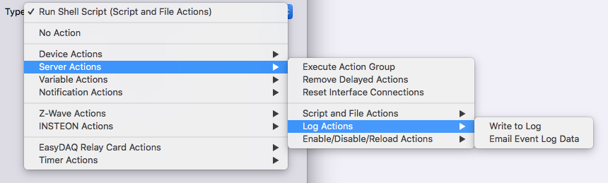

Execute Action Group - executes an Action GroupRemove Delayed Actions - removes delayed actions with the following options:Remove all delayed actions - this will remove all delayed actions regardless of delay typeRemove for device - remove any delays for the selected deviceRemove for trigger - remove any delays from the selected triggerRemove for schedule - remove any delays from the selected scheduleReset Interface Connections - resets the Insteon and X10 RF interfaces
Note: if you're running a Python 2.7 script you'll probably just want to use the Execute Script action since script files run from this plugin won't have access to the IOM (import indigo, which is Python-only). You can run Python 3 scripts from this action if you have a Python 3 interpreter installed.
