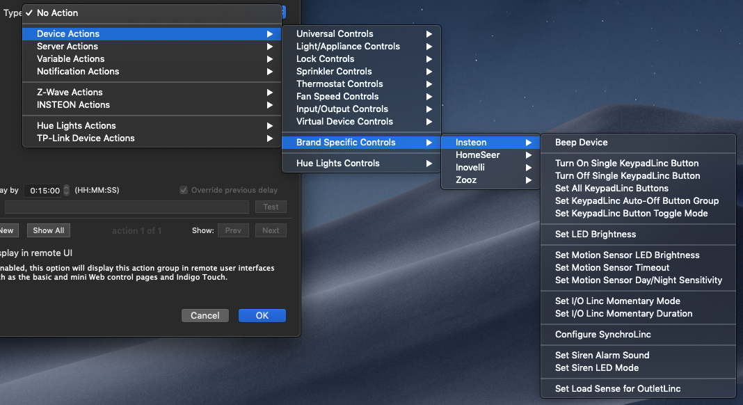

Brand Specific Controls
Brand Specific Controls Image
Insteon
HomeSeer
Inovelli
Zooz
Zooz Specific Actions Image

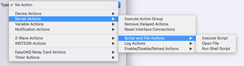

Script and File Actions
Execute Script
Execute Script Action Image
The Execute Script action allows you to execute a Python script as an embedded script or stored in a script file (you may also select an AppleScript script file). In general, you should use embedded scripts for scripts that are short and very quick to execute.
Embedded scripts will be limited to 10 seconds of execution time - if they run longer than that they will be killed. If you have a script that is a long running script you should save it in a separate file and execute it from the file by selecting the File radio button then selecting the file. Scripts executed from files are executed in their own process and are therefore much less likely to adversely affect the server process if they don't work as expected.
Open File
Open File Action Image
Run Shell Script
Run Shell Script Action Image
Note: if you're running a Python 2.7 script you'll probably just want to use the Execute Script action since script files run from this plugin won't have access to the IOM (import indigo, which is Python-only). You can run Python 3 scripts from this action if you have a Python 3 interpreter installed.

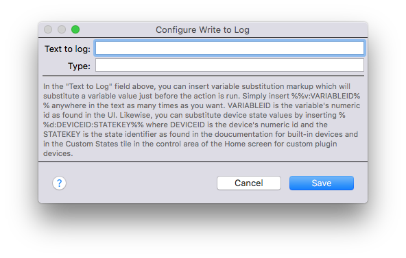

Write to Log
Write to Log Action Image

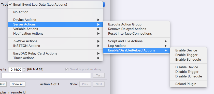

Enable/Disable/Reload Actions
Enable Type Menu Image
Enable Device
Enable Trigger
Enable Schedule
Disable Device
Disable Trigger
Disable Schedule
Reload Plugin
Reload Plugin Dialog Image
This action will restart the specified plugin. You must know the ID of the plugin: you can find the ID in a plug's detail page in the Plugin Store.

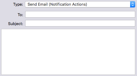

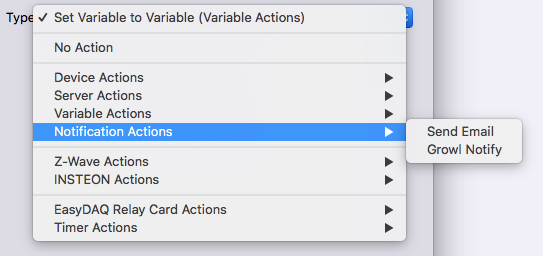

Send Email
Send Email Action Image
