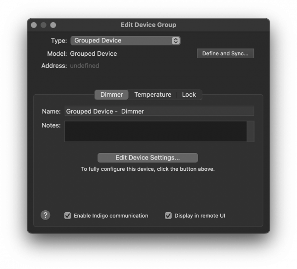

Device Factory
One way to create “multifunction” devices is to use Indigo's Device Factory method. Device Factory devices are defined by using a special <DeviceFactory> node in Devices.xml. A basic Device Factory device definition would look something like this:
<DeviceFactory>
    <ConfigUI>
        </Field>
            <Label>Name:</Label>
        </Field>
    </ConfigUI>
</DeviceFactory>
<DeviceFactory>
    <ConfigUI>
        </Field>
        </Field>
    </ConfigUI>
</DeviceFactory>

    new_dev.subModel = "Dimmer"
    new_dev.replaceOnServer()
    new_props['name'] = my_name
    new_dev.subModel = "Lock"
