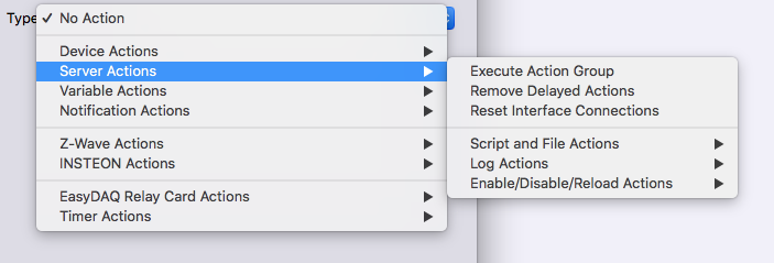

Server Actions

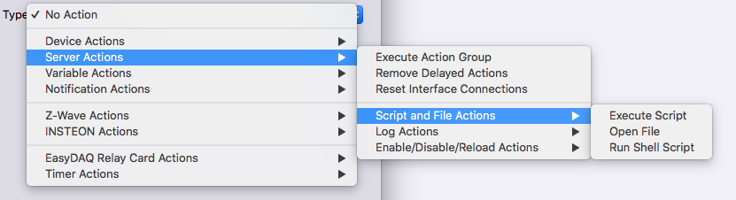

Script and File Actions
Execute Script
Execute Script Action Image
The Execute Script action allows you to execute a Python script as an embedded script or stored in a script file (you may also select an AppleScript script file). In general, you should use embedded scripts for scripts that are short and very quick to execute.
Open File
Open File Action Image

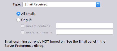

Email Received
Email Received Trigger Image

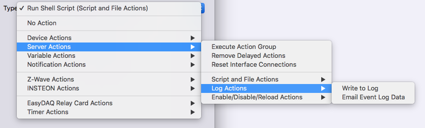

Log Actions
Log Actions Type Menu Image

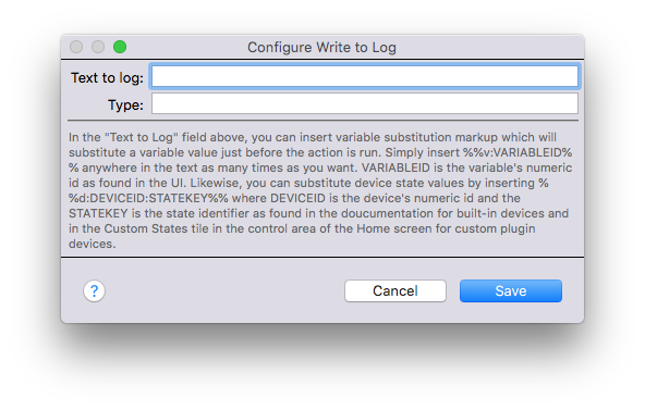

Write to Log
Write to Log Action Image

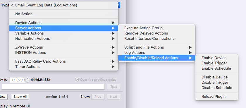

Enable Type Menu Image
Enable Device
Enable Trigger
Enable Schedule
Disable Device
Disable Trigger
Disable Schedule
