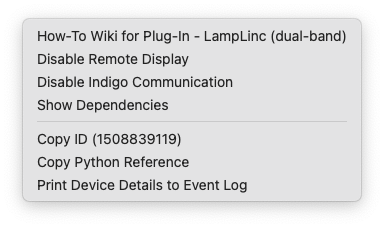

Device Contextual Menu Image
This menu will:
  7. Print all the information about a device to the Event Log window. It will look something like this:

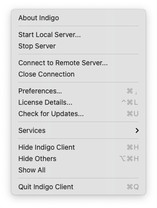

Indigo 2021.2 Menu
Indigo Menu Image
  • About Indigo 2021.2 - this will show the About window which will show what client and server versions you're running and will show your registration code
  • Preferences... - this opens the preferences dialog

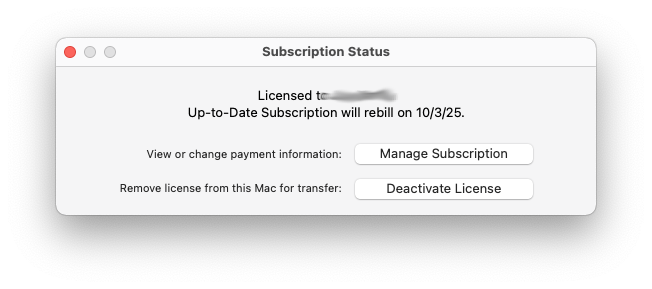

  • License Details... - this opens the Subscription Status window that will show you the status of your License and it's associated Up-to-Date Subscription:
Subscription Status Image

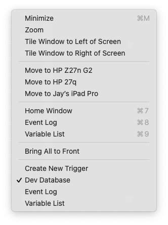

Window Menu

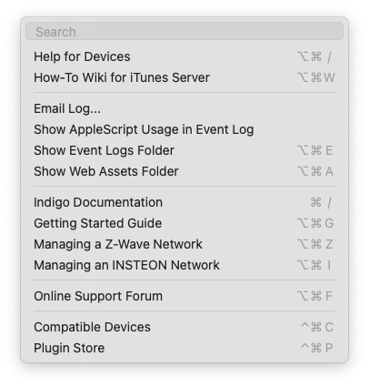

Help Menu
Help Menu Image
  • Email Log... - this option will email some of your event log data to the specified email address. Particularly useful for technical support
  • Show AppleScript Usage in Event Log - this option will print a list of AppleScripts that are embedded in actions that you have specified. This will help to identify and replace those scripts.
  • Show Event Logs Folder - this option will switch to the Finder and open the folder that contains the Event Log log files.
  • Show Web Assets Folder - this option will switch to the Finder and open the folder that contains custom images, text files, etc., that you might want to give Indigo (and others) access to through the Indigo Web Server.
  • Indigo Documentation - this will open your browser to the landing page for all Indigo 2021.2 documentation
