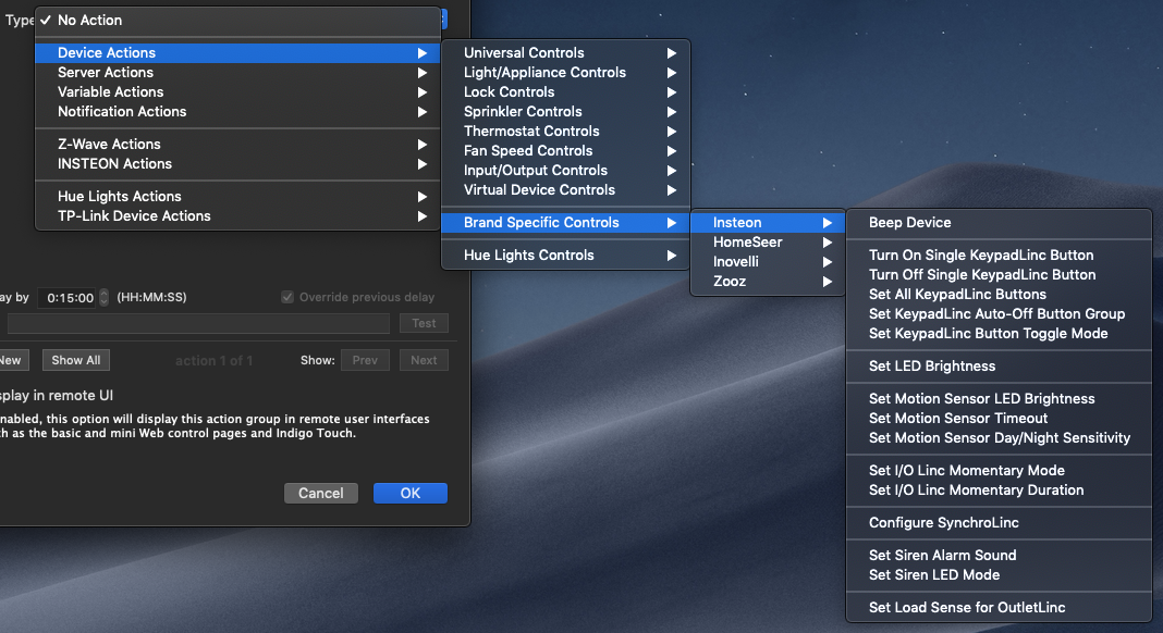

Brand Specific Controls
Brand Specific Controls Image
Insteon
HomeSeer
Inovelli
Zooz
Zooz Specific Actions Image

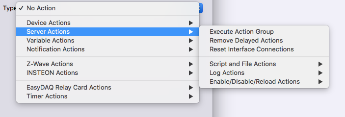

Server Actions

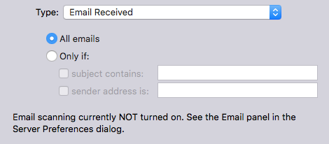

Email Received
Email Received Trigger Image

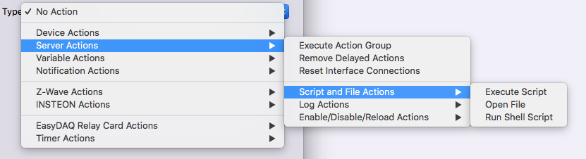

Script and File Actions
Execute Script
Execute Script Action Image
Open File
Open File Action Image
This will open the specified file (full path using *nix slashes ("/")) using the default application. If it's the path to an application (e.g. "/Applications/TextEdit.app") then it will launch that app. You can also add command-line options and include markup that will do variable (%%v:VARIDHERE%%) and device state (%%d:DEVIDHERE:STATEIDHERE%%) substitutions. Notesing of the selected schedule. You can specify an optional complementary Auto-enable after X minutes action.

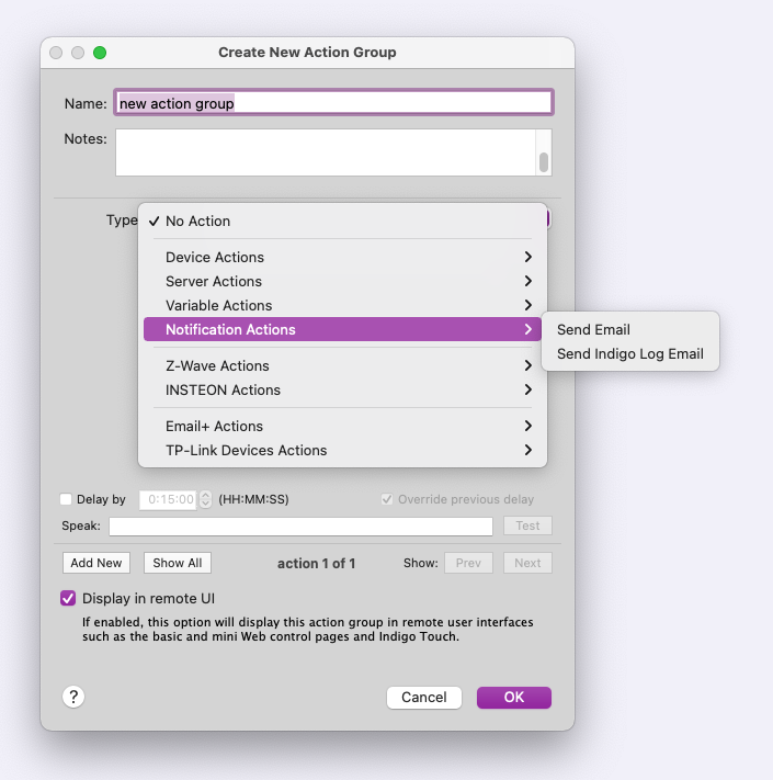

Notification Actions
Send Email
Send Indigo Log Email

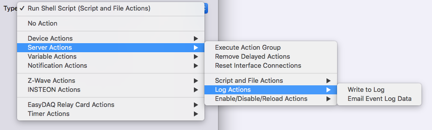

Log Actions
Log Actions Type Menu Image

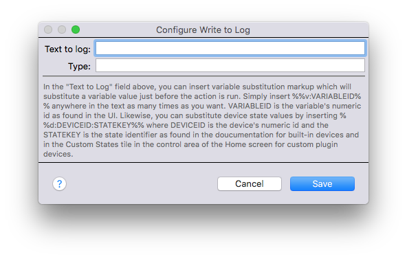

Write to Log
Write to Log Action Image
Email Event Log Data
Email Log Action Image
This action will send an email to the specified email addresses that contains the specified number of lines from the log file. This is useful for debugging problems (among other things). Tipe Action Image](images/insert_device_state_into_variable_action.png)

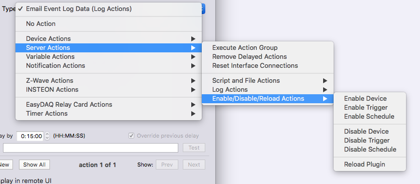

Enable Type Menu Image
Enable Device
Enable Trigger
Enable Schedule
Disable Device
Disable Trigger
Disable Schedule
Reload Plugin
Reload Plugin Dialog Image
