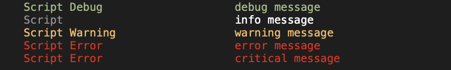

import logging
Embedded Script Logging Image
