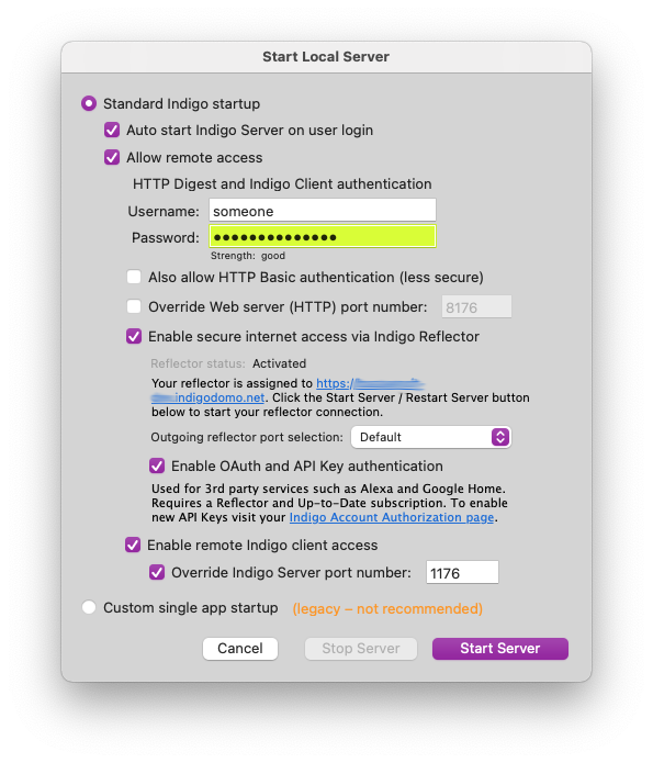

Starting Indigo Server
  1. Double click the Indigo 2022.2 application (/Applications/Indigo 2022.2.app).
  2. If this is the first time to run Indigo 2022.2 on this Mac, then press the Start Local Server... button in the connection status window.
  3. If you want to reconfigure the Indigo Server on a Mac already running Indigo, then select the Indigo 2022.2->Start Local Server... menu item.
Start Server Dialog Image
Standard startup mode
Custom single app startup
Starting the Server
