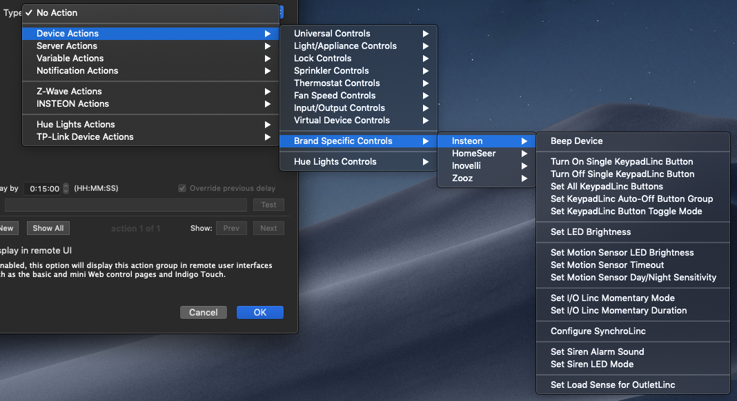

Brand Specific Controls
Brand Specific Controls Image
Insteon
HomeSeer
Inovelli
Zooz
Zooz Specific Actions Image

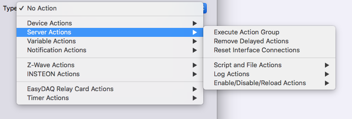

Server Actions

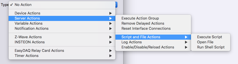

Script and File Actions
Execute Script
Execute Script Action Image
Open File
Open File Action Image

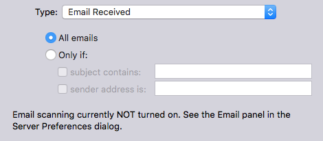

Email Received
Email Received Trigger Image

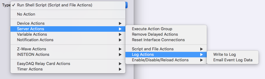

Log Actions
Log Actions Type Menu Image

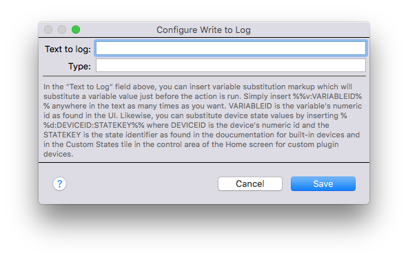

Write to Log
Write to Log Action Image
Email Event Log Data
Email Log Action Image
This action will send an email to the specified email addresses that contains the specified number of lines from the log file. This is useful for debugging problems (among other things). Tipe Action Image](images/insert_device_state_into_variable_action.png)

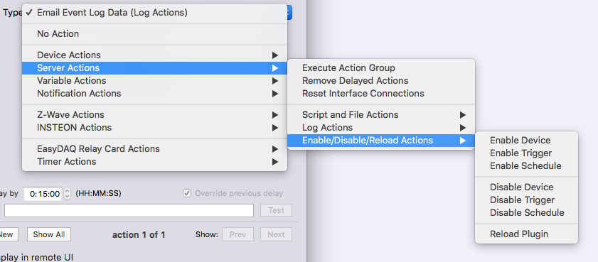

Enable Type Menu Image
Enable Device
Enable Trigger
Enable Schedule
Disable Device
Disable Trigger
Disable Schedule
Reload Plugin
Reload Plugin Dialog Image

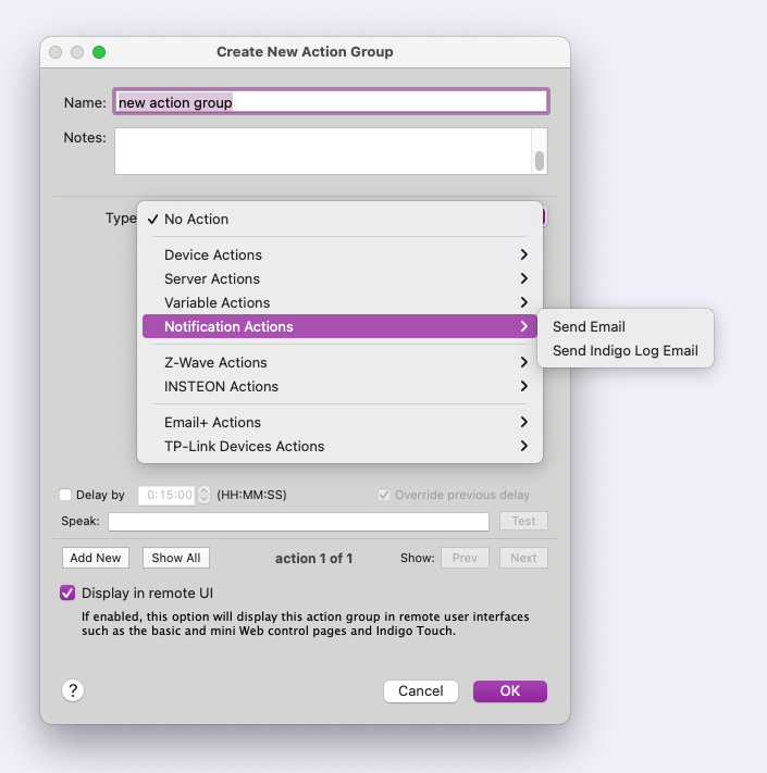

Action Groups
It is important to note that individual actions are run independently. If you need your actions to be executed in a specific order, you can use "Delay by" (see image). Very often, even short delays will be enough).
To create a new action group:
Action Group Dialog Image
