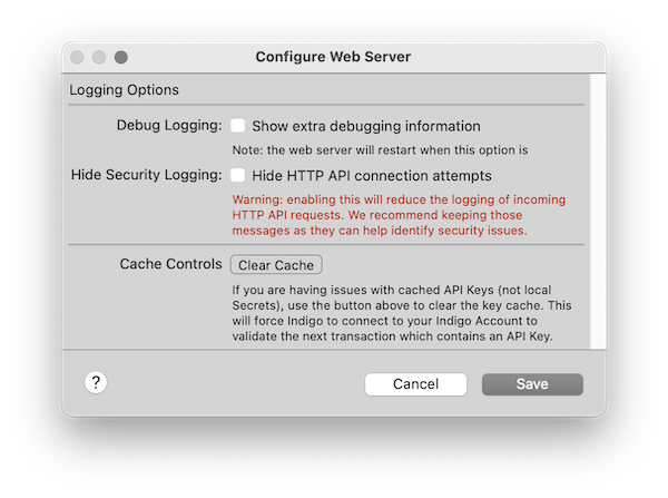

Advanced Web Server Settings
Web Server Settings Image
Beginning with Indigo 2023.1, an Advanced Web Server Settings... menu item was added to the Indigo menu. The menu has three options:
  1. Debug Logging: Enable this setting to show extra Web Server debugging information.
  2. Hide Security Logging: Enable this setting to hide HTTP API connection attempts. Warning: enabling this will reduce the logging of incoming HTTP API requests. We recommend keeping these messages as they can help identify security issues.
  3. Cache Controls: If you are having issues with cached API Keys (not Local Secrets), use the button to clear the key cache. This will force Indigo to connect to your Indigo Account to validate the next transaction which contains an API Key.
