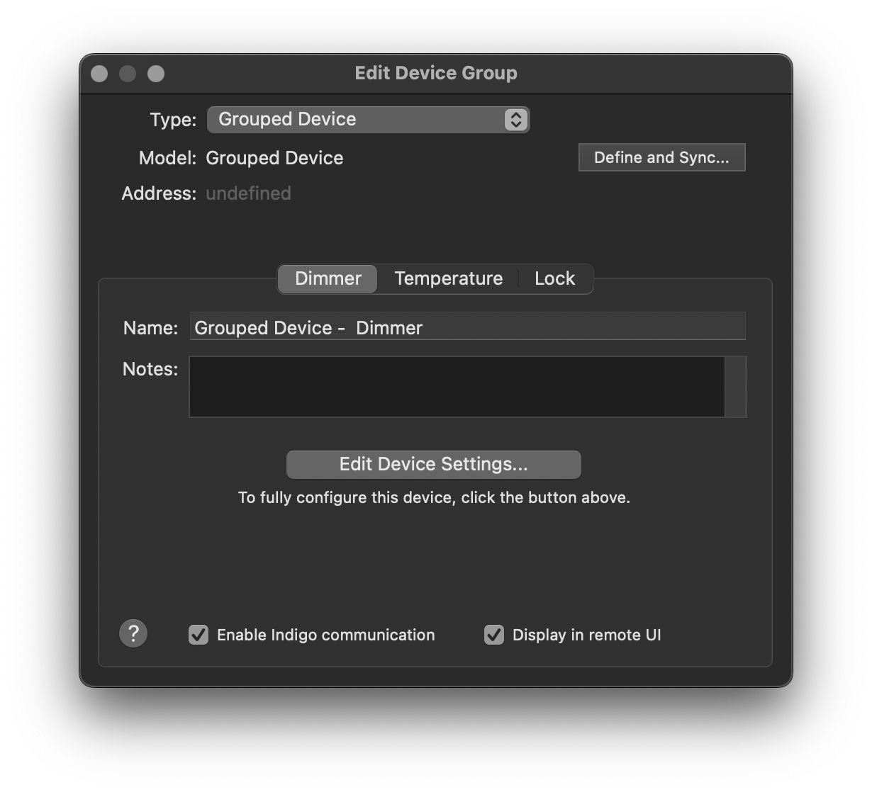

Device Factory
One way to create "multifunction" devices is to use Indigo's Device Factory method. Device Factory devices are defined by using a special <DeviceFactory> node in Devices.xml. A basic Device Factory device definition would look something like this:
<DeviceFactory>
    <ConfigUI>
        </Field>
            <Label>Name:</Label>
        </Field>
    </ConfigUI>
</DeviceFactory>
Note that when the <Device Factory> node is present, devices that include the subType attribute will not be presented to the user as individual device types when they elect to create a new plugin device (it's not possible to have a Device Factory implementation and individual plugin device definitions together). You define sub-devices like any other device type, with the addition of the subType attribute:
<DeviceFactory>
    <ConfigUI>

    new_dev.subModel = "Dimmer"
    new_dev.replaceOnServer()
    new_props['name'] = my_name
    new_dev.subModel = "Lock"

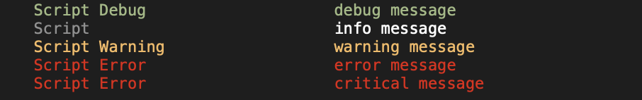

Logging
Attribute Description
The Python logger module is extremely powerful and flexible, and we recommend reading through the docs for a good understanding of how it works and how you can add great logging to your plugin. We'll describe the minimum here that you need to know to do basic logging to the Indigo Event Log window and to your plugin's log file. The logger module defines 5 levels of logging shown below. Instances of the Logger object can be set to log messages at any of those 5 levels, and the level logged can be changed at any time. By default, the self.logger instance is set to logging.DEBUG (we'll see why a bit further down). You can change this if you want using the setLevel() method. We've named the self.logger instance "Plugin", because it's the name of the class from which your plugin begins. We'll see why this is important later in the examples.
self.indigo_log_handler
The self.indigo_log_handler is an instance of a custom Handler object that will write (or emit in Python Handler speak) your log messages into the Indigo Event Log. The message type (the left part in the Event Log) is modified so that it reflects the level of the log message (with the exception of the info level). For convenience, the various log levels are also represented in color. Here's an example of each level:
Embedded Script Logging Image
self.plugin_file_handler
Log Levels
For example,
class MyClass(object):
    def __init__():
Custom IndigoLogHandler
exc_info
    x = 1 / 0
Full Example
import logging
def __init__(self):
        x = 1 / 0
    except ZeroDivisionError:
Which yields:
    x = 1 / 0
import logging
