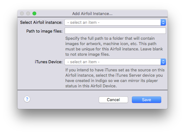

Adding an Instance
Add Airfoil Instance Image
When you click the "Save" button, the plugin will create your Airfoil Instance device, and it will query Airfoil and get all it's known speakers. It will then create devices for each of those speakers (see the next section for details on those devices).

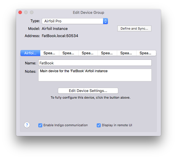

Airfoil Edit Group Image

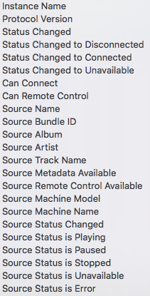

Airfoil Triggers Image
States available to Scripts
