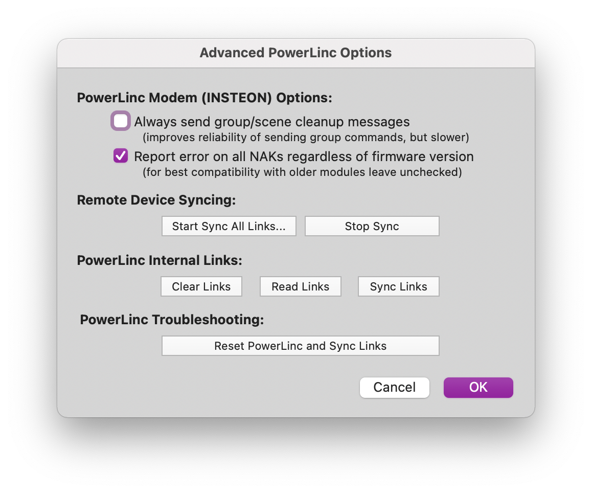

  1. Choose Indigo 2023.2->Preferences... menu, then make sure the Interfaces tab is selected.
If you click on the Interface Options... button, you'll see something like this:
First, make sure that Indigo has enabled communication with the interface. If Indigo is not online with the interface, then choose the Interfaces->INSTEON/X10 Power Line->Enable menu item. See connecting the Interface above for more details.
