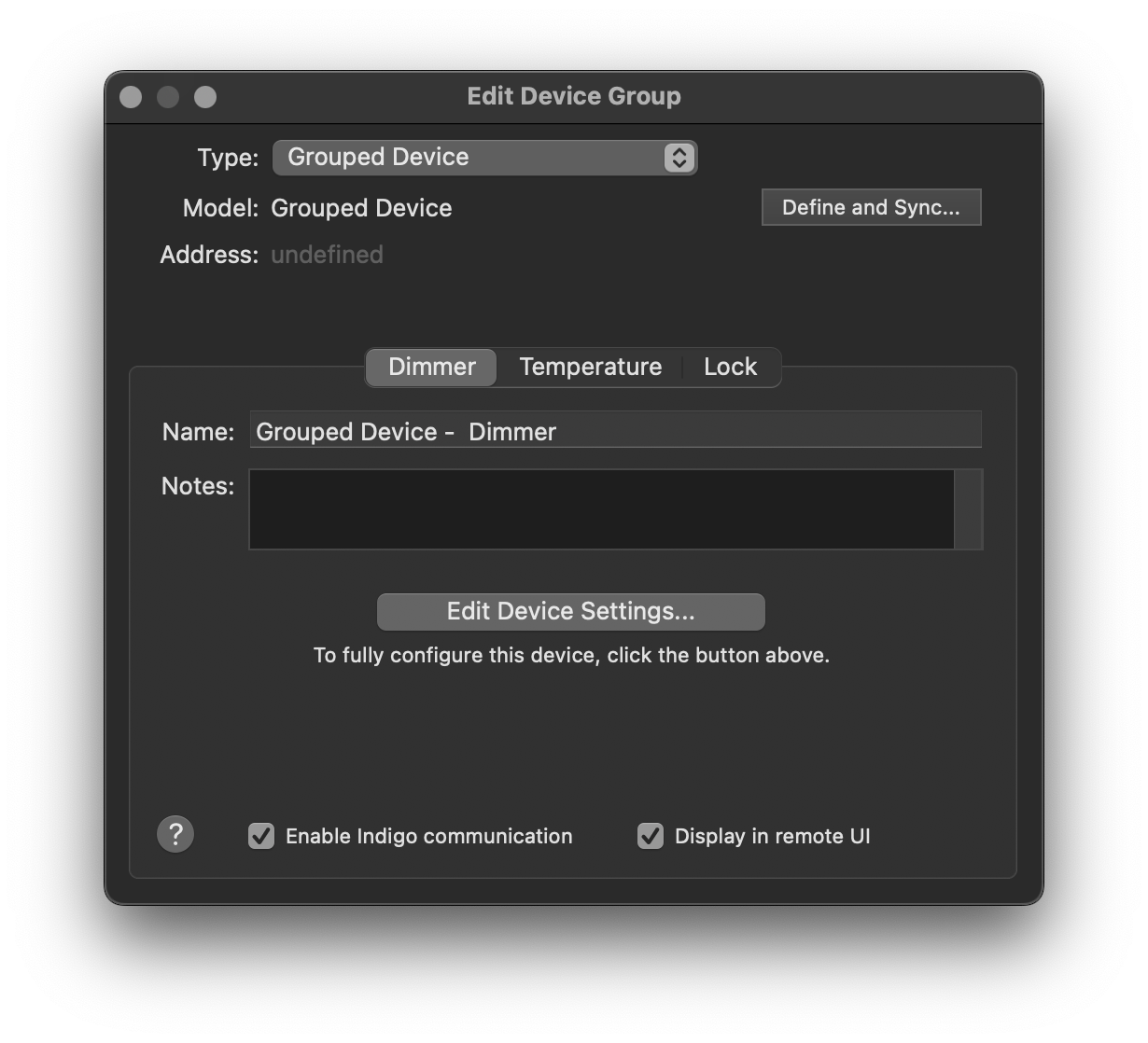

Device Sub-Types
In Devices.xml
Device Subtype Example Image
In Python:
newdev.name = u"Device 1"
When the allowUserCreation attribute is present and set to false, Indigo will not display the device model type when the user elects to create a new device (the "Model" dropdown will not contain the device type). This is especially useful for complex devices that have multiple sub-types that are set programmatically (but not created using the Device Factory approach). Your plugin may not support individual sub-types as stand-alone devices and, therefore, you wouldn't want users to be able to create them. The allowUserCreation attribute was introduced with Indigo version 2022.1.2 and API 3.1.
IMPORTANT: Plugin developers should account for each devices' callbacks when implementing built-in device types -- even if you don't use all the callbacks within your plugin. For example, if your plugin implements the Speed Control device type, your plugin should include handlers for all the Speed Control callbacks -- such as turnOn, turnOff, or toggle. This is very important because these callbacks will still be exposed in the Indigo Client UI for things like Actions and Triggers. It's best to give users an indication that the callback won't do anything in your plugin by writing a warning to the Event log. Consult the SDK for more information on each device types' callbacks and examples of how to handle them.

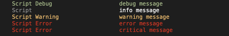

Logging
Attribute Description
The Python logger module is extremely powerful and flexible, and we recommend reading through the docs for a good understanding of how it works and how you can add great logging to your plugin. We'll describe the minimum here that you need to know to do basic logging to the Indigo Event Log window and to your plugin's log file. The logger module defines 5 levels of logging shown below. Instances of the Logger object can be set to log messages at any of those 5 levels, and the level logged can be changed at any time. By default, the self.logger instance is set to logging.DEBUG (we'll see why a bit further down). You can change this if you want using the setLevel() method. We've named the self.logger instance "Plugin", because it's the name of the class from which your plugin begins. We'll see why this is important later in the examples.
self.indigo_log_handler
The self.indigo_log_handler is an instance of a custom Handler object that will write (or emit in Python Handler speak) your log messages into the Indigo Event Log. The message type (the left part in the Event Log) is modified so that it reflects the level of the log message (with the exception of the info level). For convenience, the various log levels are also represented in color. Here's an example of each level:
Embedded Script Logging Image
self.plugin_file_handler
Log Levels
For example,
class MyClass(object):
    def __init__():
Custom IndigoLogHandler
exc_info
    x = 1 / 0
Full Example
import logging
def __init__(self):
        x = 1 / 0
    except ZeroDivisionError:
Which yields:
    x = 1 / 0
import logging
