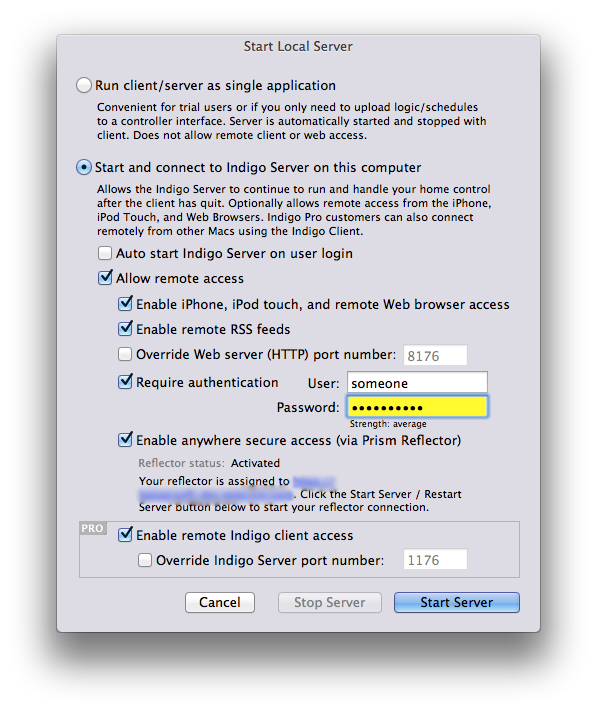

Starting Indigo Server
  1. Double click the Indigo 7.2 application (/Applications/Indigo 7.2.app).
  2. If this is the first time to run Indigo 7 on this Mac, then press the Start Local Server... button in the connection status window.
  3. If you want to reconfigure the Indigo Server on a Mac already running Indigo, then select the Indigo 7->Start Local Server... menu item.
Start Server Dialog Image
If you only have one Mac and do not wish to remotely access Indigo from a Web browser, iPhone, or iPod Touch, then you can choose the Run client/server as single application radio button. This will automatically run the client/server as a single application. This requires that the Indigo UI always be running on your Mac - when you quit the Indigo 7 Client application (Indigo 7->Quit) all Indigo event processing (triggers, schedules, scripts, etc.) will cease processing. This is not our recommended configuration.
!!! warning "NOTE" Indigo Server must be running to use Indigo Touch or to access the Indigo Web Server.

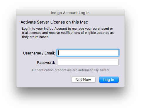

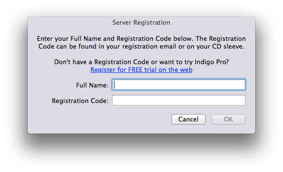

Login Dialog Image
and enter your Indigo Account username (or email) and password.
OR for Indigo 7.0.x, the server registration dialog:
Registration Window Image
enter you name and registration code exactly as they appear in your registration email (copy/paste works best) and click OK.
In either case, the server will continue to start up.
If you purchased a retail disk, you should enter your full first and last name along with the registration code exactly as it appears on the label on the disk sleeve. When you click OK you'll be prompted to register your copy on our website.
While this isn't required, it's highly recommended. If you don't, we won't be able to locate your registration code in the future should you need it again - and you will to get discounted upgrades to major new releases and access to dot releases.

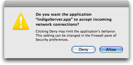

  6. Restart the Indigo Server by choosing the Indigo 7->Start Local Server... menu item and pressing the Start Server button.
  7. Mac OS X will now ask your permission to allow incoming network connections for the application IndigoServer.app and Python.app. Press the Allow button for each.
Firewall Prompt Image

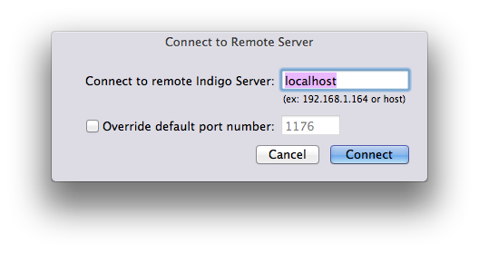

  2. Double click the Indigo 7.2 application (inside /Applications/Indigo 7.2.app) on the remote Mac.
  3. If this is the first time to run Indigo 7 on this remote Mac, then press the Connect to Remote Server... button in the connection status window.
  4. If you are wanting to connect to a different Indigo Server, then select the Indigo 7->Connect to Remote Server... menu item.
  7. Press the Connect button.
Client Connect Dialog Image

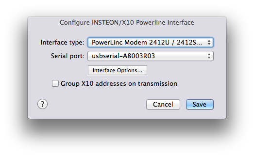

Connecting the Interface
  1. Choose Indigo 7->Preferences... menu, then make sure the Interfaces tab is selected.

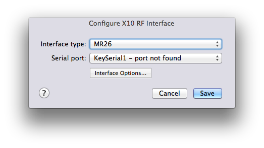

Connecting X10 RF Interfaces
The process for connecting X10 RF Interfaces is basically the same as for power line interfaces - you just need to select the correct serial port. The W800USB will require installing the FTDI drivers mentioned above. You only need to use this interface if you're using a separate X10 RF interface like the W800 or MR26. If you are using a CM15 then enable it in the #Connecting INSTEON and X10 Power Line Interfaces section above.
X10 RF Configuration Dialog Image

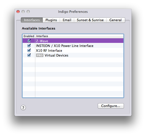

Interface Preferences
Interfaces Tab Image
You can also enable/disable and configure the various built-in interfaces by selecting the Interfaces->Manage Interfaces... menu item or by opening the preferences dialog by selecting the Indigo 7->Preferences... menu item then clicking on the Interfaces tab.

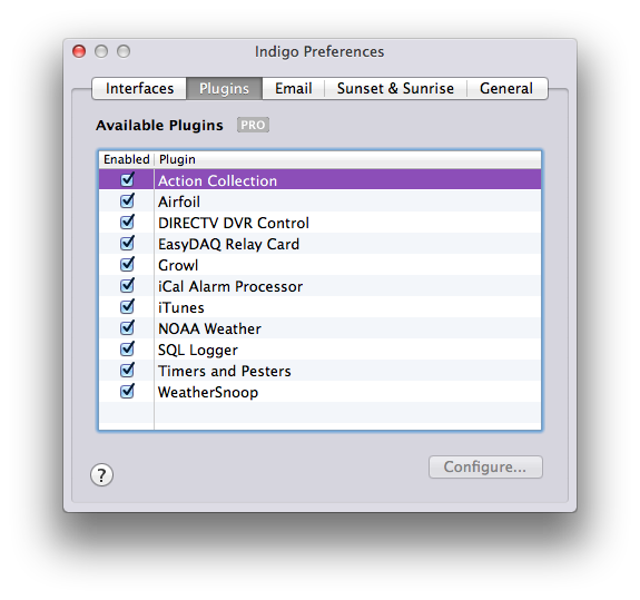

Installing Plugins, Configuring Plugin Settings, Permanently Removing Plugins
Indigo includes the ability to use plugins developed by 3rd party developers (see our Plugin Store for available plugins). To install a plugin, just download it from the source (the Plugin Store or wherever else you may get it) onto your Indigo Server Mac, then in the Finder double-click the .indigoPlugin file (if the file ends with .zip, then you will have to unzip it first by double-clicking). This will open the Indigo Mac Client application and ask you if you want to install it. If you agree, the first time you install a plugin it will automatically open the plugin's configuration dialog (if it has one).
You can also open the config window choosing the Indigo 7->Preferences... menu item and clicking the Plugins tab. Make sure the plugin is enabled (by checking the Enabled checkbox) then double-click on the plugin's name (or select it and click the Configure... button).
Again, if this is the first time the plugin has been enabled this will open the configuration dialog for the individual plugin if the plugin supports a one.
Plugins Tab Image
You can also enable/disable and configure the various plugins by selecting the Plugins->Manage Plugins... menu item or by opening the preferences dialog by selecting the Indigo 7->Preferences... menu item then clicking on the Plugins tab.

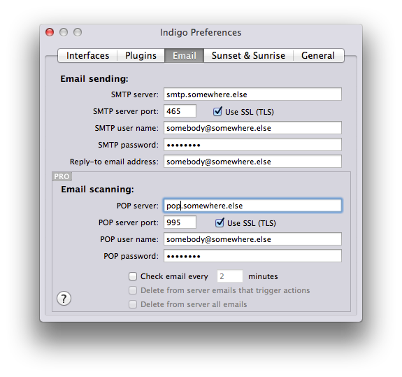

Configuring Email Settings
Typically, ISPs or other email service providers allow multiple email addresses for each customer. We recommend that you create a new email address specifically for Indigo, such as jetsons-house@myisp.com. Using a separate email address for Indigo will eliminate the possibility that Indigo might trigger an action from a personal email not intended for Indigo, and will allow you to use the Delete from server options shown below to reduce mailbox clutter.
Email Tab Image
To configure email sending
  1. Choose Indigo 7->Preferences... menu item, then make sure the Email tab is selected.
To configure email scanning

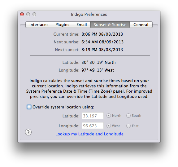

Longitude Latitude Tab Image
  • Choose the Indigo 7->Preferences... menu item, then make sure the Sunset & Sunrise tab is selected.

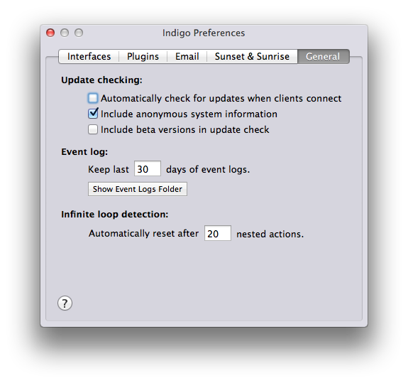

General Preferences Tab Image
You can configure other Indigo settings by opening the preferences dialog (selecting the Indigo 7->Preferences... menu item) and clicking on the General tab.
You can have Indigo check for updates immediately by selecting the Indigo 7->Check for Updates... menu item.

Indigo ships with quite a few very useful plugins. We install these plugins disabled so you'll only need to enable the ones you want to use. There are two ways to enable/disable a plugin: select the Enable (or Disable as the case may be) menu item under the plugin's submenu on the Plugins menu. The other is to select the Plugins->Manage Plugins... menu item which will open the Indigo Preferences window to the Plugins tab. Installing 3rd party plugins is a very simple process as well.
