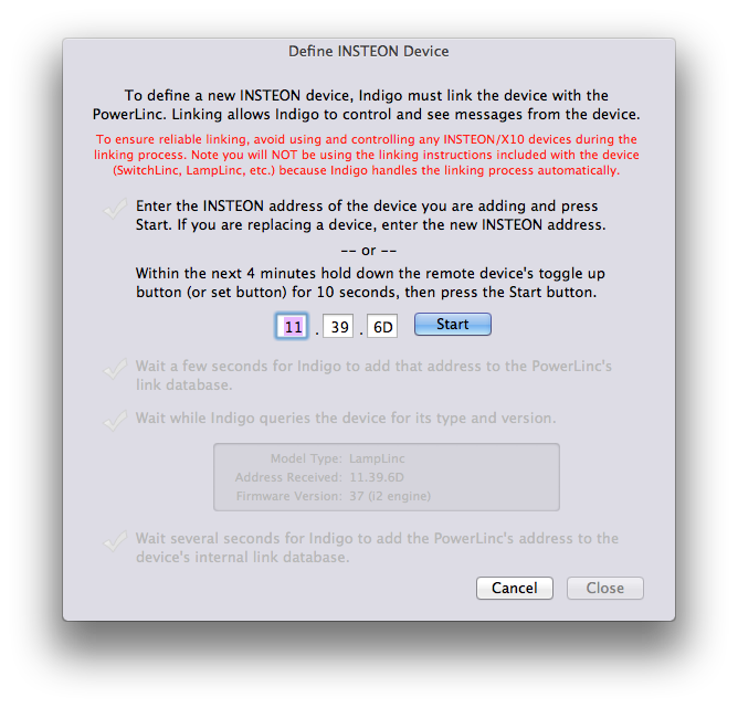

To add a new Insteon device:
  2. Press the New... button at the top of the Home window.

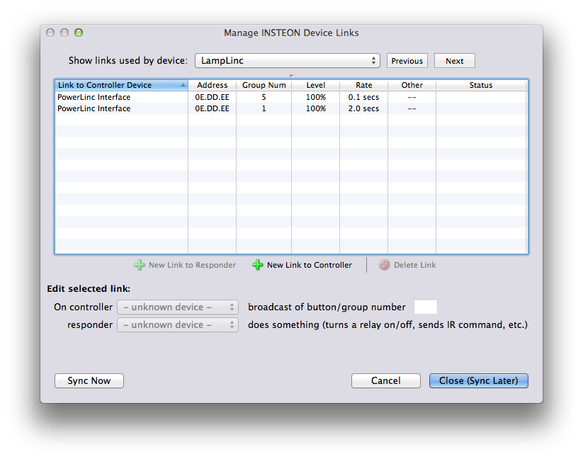

For example, you can use Indigo to remotely program button #1 on a RemoteLinc to: set the thermostat to 68°, brighten the bedroom sconces to 75%, dim the bedroom overhead fixture down to 35%, turn off the hallway and bathroom lights.
Device Links Example Image

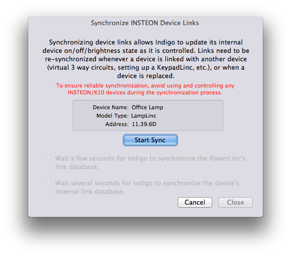

Indigo automatically creates the links to define the scene in most remote modules. This means you do not have to press-and-hold the set button or up paddle on most remote modules. Indigo will do it all remotely for you with a single press of the Sync Now button. See the Supports Remote Link Management column of the INSTEON module and Indigo 4 compatibility table for information on which modules Indigo can remotely manage.

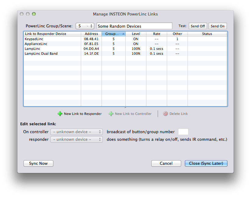

You can also define Indigo initiated scenes to control multiple remote modules in unison. See the defining Indigo INSTEON scenes section for more information on this capability.
Manage Powerlinc Scenes Image
Defining the Scene
Executing the Scene
