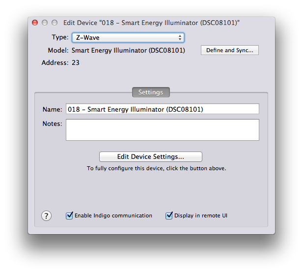

Device Dialog Z-Wave Image

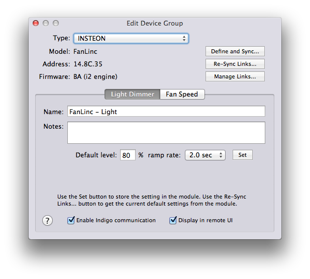

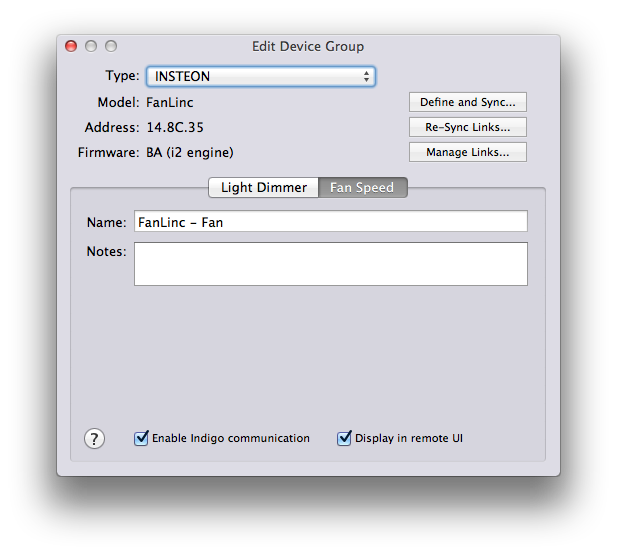

Device Options
Fanlinc Dimmer Image Fanlinc Fan Speed Image

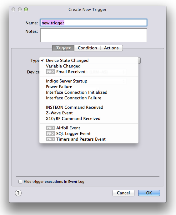

Triggers
Trigger Dialog Image

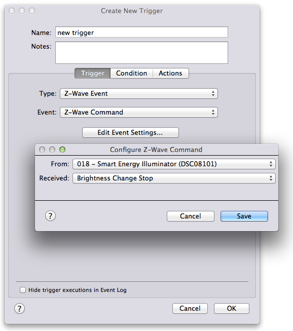

Z-Wave Command Received
Use the Type Z-Wave Command Received to trigger an action when Z-Wave commands are sent from a device, like a scene controller or motion sensor, and then received by the Z-Wave interface. Each device type will have different options based on it's capability

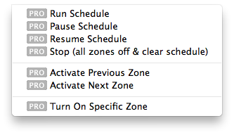

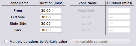

Sprinkler Controls
Sprinkler Action Image
  • Run Schedule - selecting this action will show you the zone table (shown above) that will allow you to set the duration for each zone and optionally multiply those durations by the selected variable. This last option is useful if you change durations based on time of year - you can change the variable value but keep the existing schedule and it'll adjust the duration as appropriate. Sprinkler Schedule Action Image

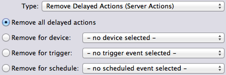

Remove Delayed Actions
Remove Delayed Action Image

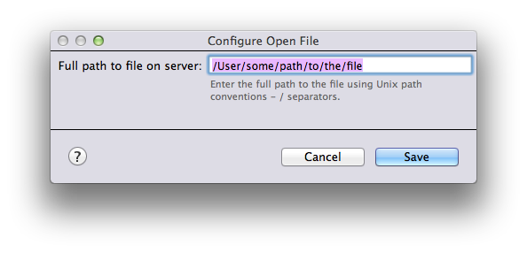

Open File
Open File Action Image

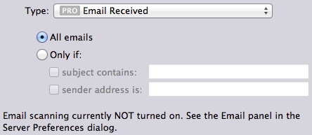

Email Received
Email Received Trigger Image

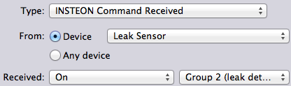

INSTEON Command Received

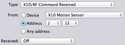

X10/RF Command Received

Sprinkler Controls

Open File
This will open the specified file (full path using *nix slashes ("/")) using the default application. If it's the path to an application (e.g. "/Applications/TextEdit.app") then it will launch that app. You can also add command-line options and include markup that will do variable (%%v:VARIDHERE%%) and device state (%%d:DEVIDHERE:STATEIDHERE%%) substitutions. Noteing of the selected schedule. You can specify an optional complementary Auto-enable after X minutes action.

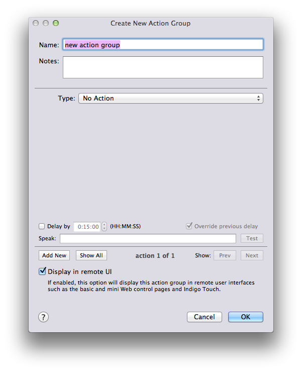

Action Groups
To create a new action group:
Action Group Dialog Image

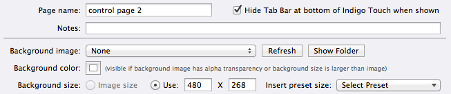

Control Pages
Control Page Editor
To create a new Control Page, select `View->: file paths that contain spaces will need to have the spaces escaped with a backslash - /some\ path/that\ has/escaped\ spaces/.

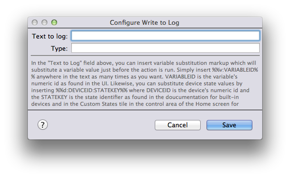

Write to Log
Write To Log Action Image

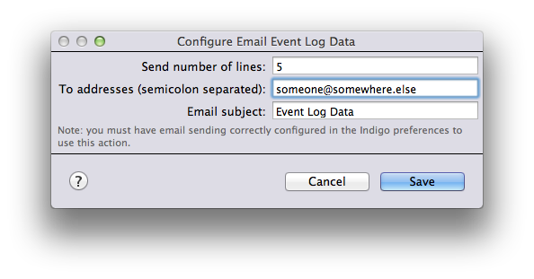

Email Event Log Data
Email Log Action Image
This action will send an email to the specified email addresses that contains the specified number of lines from the log file. This is useful for debugging problems (among other things). Tiped variable. After you specify the device, click the Edit Action Settings... button and it will open a dialog (shown above) with a list of all possible states for the device you selected and a popup of all variables. You can create a trigger that executes when a device's state changes and have it insert the new state into the variable.

Control Pages
Control Page Editor
To create a new Control Page, select View->: this action is also available interactively by selecting theHelp->Email Log...` menu item.

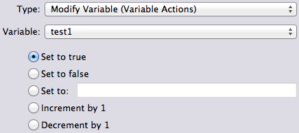

Modify Variable
Modify Variable Action Image

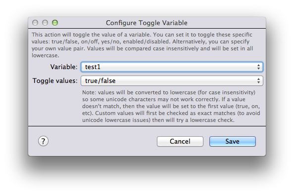

Toggle Variable
Toggle Variable Action Image

Control Pages
Control Page Editor
Control Page Editor Image
Page Element Examples Image

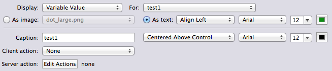

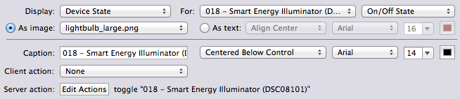

Device State
Variable Value

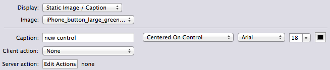

Static Image/Caption
Refreshing Image URL

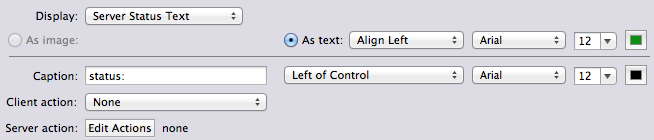

Server Status Text
Server Status Icon

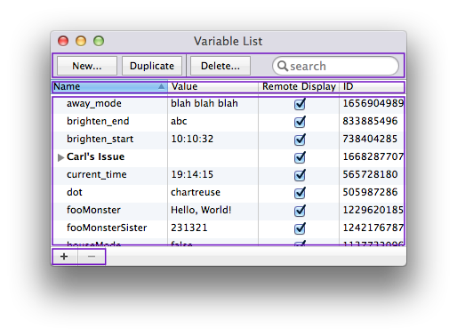

Variables
Variables are used to hold information that can help your home automation logic. For instance, Indigo ships with an AppleScript which stores weather information in variables. You can use that information to display on control pages, as part of your conditional logic (see #Conditions below), or as a trigger for some other action.
Variable Window Image

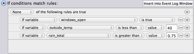

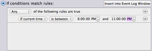

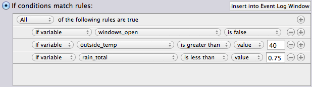

Conditions
Conditions Tab Image
Motion Sensor Example Image
  2. if it's too cold outside
Sprinkler Condition Image
Complex Condition Rule Image
    "If dark"
