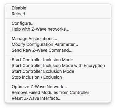

Z-Wave Menu Options
Z-Wave Menu Image

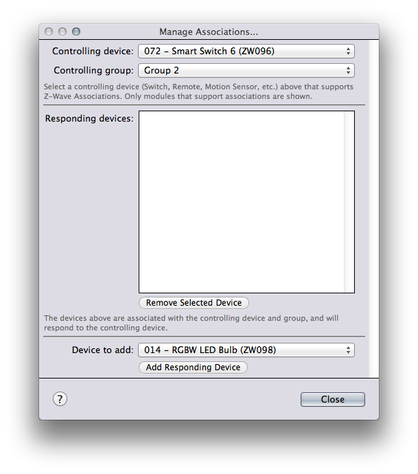

Manage Associations

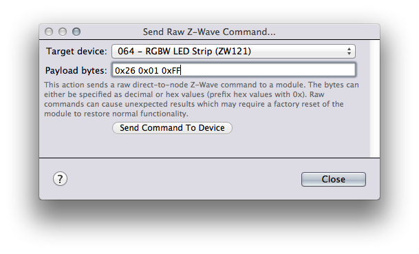

Send Raw Z-Wave Command
Stop Inclusion / Exclusion

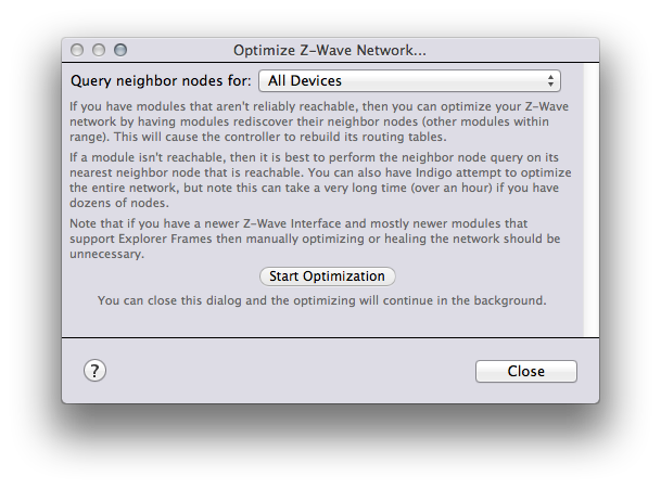

Optimize Z-Wave Network
If a Z-Wave device is no longer available to your network (it failed, etc) then you can use this menu item to remove it from the interface. You might need to attempt a Define and Sync on the device (and allow it to fail) just before using this menu item.
Reset Z-Wave Interface
