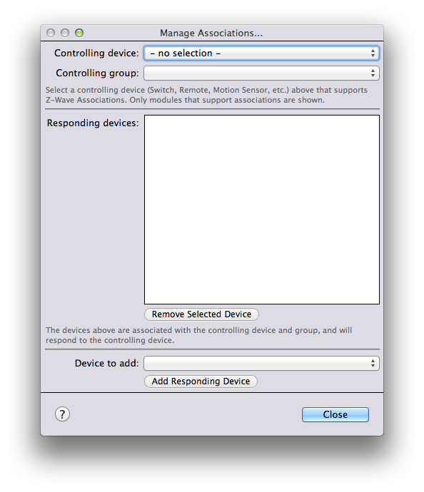

To edit associations, select Interfaces->Z-Wave->Manage Associations....
The Controlling device popup lists all Z-Wave devices in your system that support control associations. Once you select one of those (if you have any), then the Controlling group popup will show how many different association groups the device can control. The Responding devices list shows all Z-Wave devices that are being controlled by the selected device/group. Select any you want to delete and click the Remove Selected Device button to remove them from the association. Select a device from the Device to add popup and click Add Responding Device to add the device to the association.
