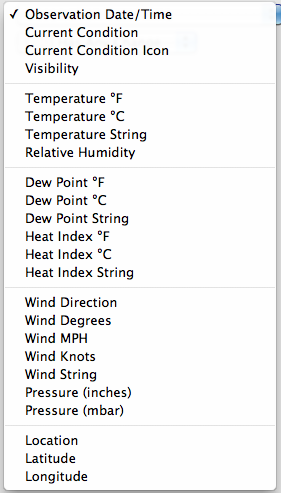

NOAA Trigger States Image
Weather Station device types provide you with several device states that you can use in the Trigger dialog:
  • Current Condition - The current condition in a word or two
  • Current Condition Icon - The current condition icon - Indigo ships with "NOAA Condition+.png" and it's children, one for each condition that's returned in this field. So, in the control page editor, select this state and "NOAA Condition+.png" and you'll have a nice conditions icon (images provided by NOAA).
  • Dew Point °C - Dew point in Celsius
  • Dew Point °F - Dew point in Fahrenheit
  • Dew Point String - Dew point in a human-readable string
  • Heat Index °C - Heat index in Celsius
  • Heat Index °F - Heat index in Fahrenheit
  • Heat Index String - Heat index in a human-readable string
  • Humidity - The relative humidity
  • Latitude - Latitude
  • Location - Location in human-readable form
  • Longitude - Longitude
  • Observation Date/Time - The last time NOAA updated the data. This field is in YYYY-MM-DD HH:MM:SS so it can be parsed by other software if needed.
  • Pressure (inches) - Pressure in inches
  • Pressure (mbar) - Pressure in millibars
  • Quality Codes - For scripters to account for the relative quality of the various weather observations (JSON). This state is only available in Indigo 2022.1 and later. See below for what the codes mean.
  • Temperature °C - Temperature in Celsius
  • Temperature °F - Temperature in Fahrenheit
  • Temperature String - Temperature in a human-readable string (i.e. "98.0 F (36.7 C)") - this is the state shown in the "State" column for a Weather Station device
  • Time Zone - The timezone as it applies to the observed location. This state is only available in Indigo 2022.1 and later.
  • Visibility - Visibility in miles
  • Wind Degrees - Wind direction in degrees
  • Wind Direction - Wind direction description in something close to human-readable form
  • Wind Knots - Wind speed in knots
  • Wind MPH - Wind speed in miles per hour
  • Wind String - A description of the wind in human-readable form
