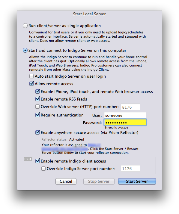

Starting Indigo Server
  1. Double click the Indigo 7.4 application (/Applications/Indigo 7.4.app).
  2. If this is the first time to run Indigo 7 on this Mac, then press the Start Local Server... button in the connection status window.
  3. If you want to reconfigure the Indigo Server on a Mac already running Indigo, then select the Indigo 7.4->Start Local Server... menu item.
Start Server Dialog Image
If you only have one Mac and do not wish to remotely access Indigo from a Web browser, iPhone, or iPod Touch, then you can choose the Run client/server as single application radio button. This will automatically run the client/server as a single application. This requires that the Indigo UI always be running on your Mac - when you quit the Indigo 7.4 Client application (Indigo 7.4->Quit) all Indigo event processing (triggers, schedules, scripts, etc.) will cease processing. This is not our recommended configuration.
!!! warning "NOTE" Indigo Server must be running to use Indigo Touch or to access the Indigo Web Server.

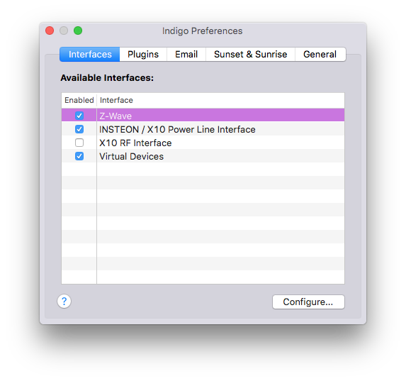

Interfaces Menu Image
Interfaces Tab Image

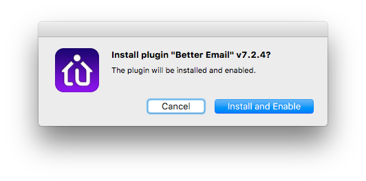

Installing Plugins
  2. Make sure that the plugin is supported by Indigo 7.2 (look for the Requires field).
  10. Done!

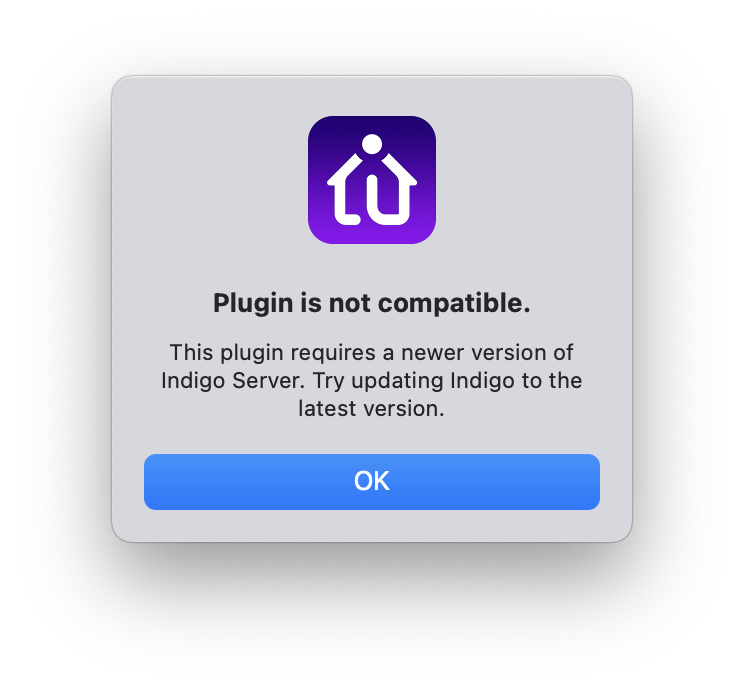

Incompatible Plugins
Note if you see the error alert below that the "Plugin is not compatible" then the version of the plugin you installed is too new to run with your Indigo Server version. In this case the best solution is to upgrade your version of Indigo Server.

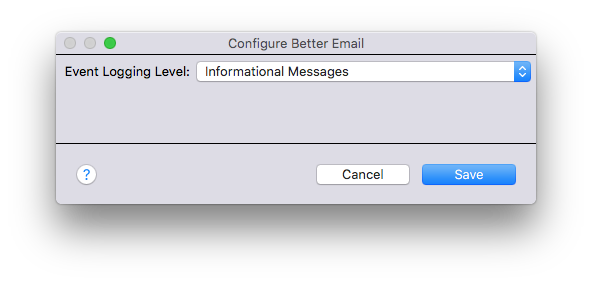

Plugin Configuration
Plugin Configuration Dialog Image

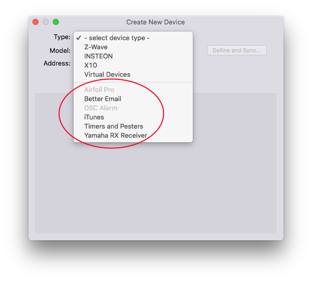

Other Menus with Plugin Items
Plugin New Device Image

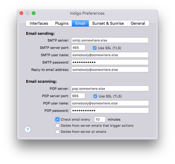

Configuring Email Settings
Typically, ISPs or other email service providers allow multiple email addresses for each customer. We recommend that you create a new email address specifically for Indigo, such as jetsons-house@myisp.com. Using a separate email address for Indigo will eliminate the possibility that Indigo might trigger an action from a personal email not intended for Indigo, and will allow you to use the Delete from server options shown below to reduce mailbox clutter.
Email Tab Image
To configure email sending
  1. Choose Indigo 7->Preferences... menu item, then make sure the Email tab is selected.
To configure email scanning

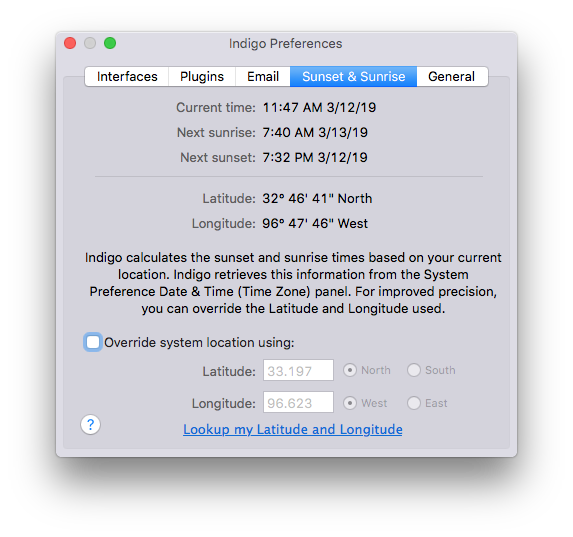

Longitude Latitude Image
  • Choose the Indigo 7.4->Preferences... menu item, then make sure the Sunset & Sunrise tab is selected.

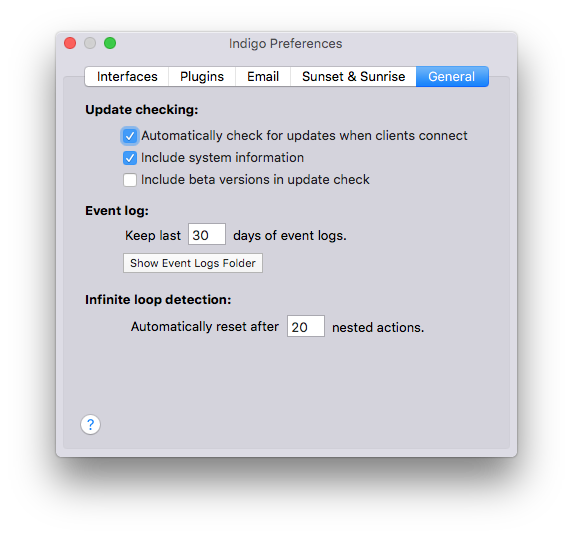

General Preferences Tab Image
You can configure other Indigo settings by opening the preferences dialog (selecting the Indigo 7->Preferences... menu item) and clicking on the General tab.
You can have Indigo check for updates immediately by selecting the Indigo 7->Check for Updates... menu item.
