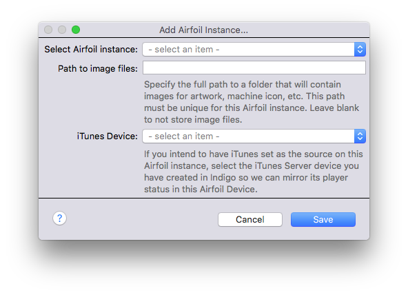

Adding an Instance
albumArt.png- an image of the currently playing album track if the source supports it (notably, iTunes)machineIcon.png- an icon representing the computer that is running this instance of AirfoilmachineIconAndScreenshot.png- a screenshot from the host computer with the machine icon overlayed (though this functionality seems to be missing in Airfoil versions through v5.1.0 - you just get the same image as the machine icon)sourceIcon.png- an icon representing the selected audio source in Airfoil.
When you click the "Save" button, the plugin will create your Airfoil Instance device, and it will query Airfoil and get all it's known speakers. It will then create devices for each of those speakers (see the next section for details on those devices).

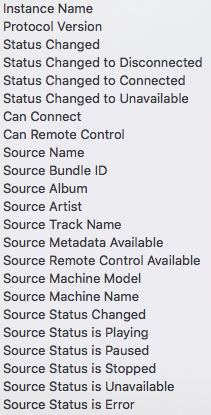

States available to Scripts
| State Key | Value Type | Description |
canConnect |
boolean | This instance allows remote speakers to connect |
canRemoteControl |
boolean | This instance allows remote control of the source |
instanceName |
string | The name of the instance. On Mac systems, this is the name of the Mac as defined in the Sharing System Preference Panel |
protocolVersion |
string | This is the version of Airfoil's API that this instance uses. v1.5 is the minimum. |
sourceAlbum |
string | The name of the album that the selected source is playing (if sourceMetadataAvailable == True) |
sourceArtist |
string | The name of the artist of the album that the selected source is playing (if sourceMetadataAvailable == True) |
sourceBundleId |
string | The unique identifier of the source |
sourceMachineModel |
string | The model of the computer running Airfoil |
sourceMachineName |
string | The name of the computer running Airfoil (usually the same as the instanceName) |
sourceMetadataAvailable |
boolean | The source supplies metadata (album, artist, track, etc) |
sourceName |
string | The name of the selected source |
sourcePlayStatus |
string (playing, paused, stopped, unavailable, error) | If the source is iTunes and you've selected an iTunes server as the source in this device's config, this will mirror that device's playState |
sourceTrackName |
string | The name of the track that the current source is playing (if sourceMetadataAvailable == True) |
status |
string (disconnected, connected, unavailable) | The status of this device with respect to the Airfoil communication |

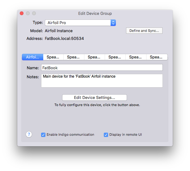

Notes
Speaker
Each Airfoil Instance device has a collection of "Speaker" devices in its group. These are all the various outputs to which Airfoil can direct its source audio. These devices are created automatically when you create your Airfoil Instance and any time a new source gets added to the instance. For instance, if you create an Airfoil Instance and it finds 3 speakers, then at a later time you add a bluetooth speaker to the Mac that Airfoil is running on, the plugin will automatically create a new speaker device for that bluetooth speaker.
Warning: you can't use the Delete... button above the device list without deleting ALL the devices in that Airfoil Instance Group. If you need to delete just a single speaker, select the Plugins->Airfoil Pro->Permanently Delete Speaker menu item. This will allow you to just delete a single speaker.
