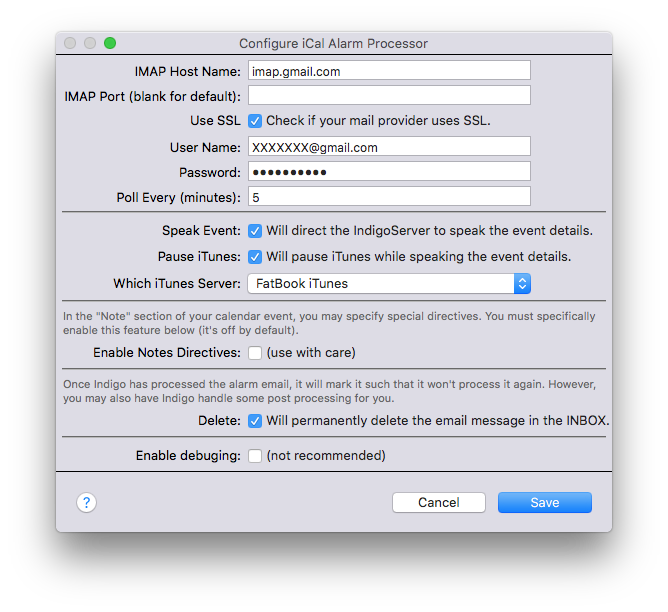

iCal Configuration Window Image
The first section allows you to configure the settings for your IMAP server and how often the plugin will poll the server for new email messages. Check with your email provider for port and SSL settings.
The next section provides some simple speech options. The first option will have the IndigoServer application speak the event and it's time. This speech will happen through the standard sound output on your IndigoServer Mac. If you're using Airfoil, you can have the sound directed out to Airport Expresses and AppleTVs - a simple way to get whole-home audio. Optionally, you can have the iTunes plugin perform the speech - it will first pause iTunes if it's playing, speak the event, then resume iTunes as necessary.
The next section will turn on an advanced feature - in the "notes" field of an iCal event, you may insert some specially formatted text that can be processed by the plugin when an event email is received. You can have Triggers, Schedules, or Action Groups executed, and for the first two you can specify whether conditions associated with them are evaluated or not. Here are a few examples:
Execute a Group Group::1282734394
Execute a Trigger skipping Conditions Trigger::982343093::False
Execute a Schedule evaluating Conditions Schedule::982343093::True
Each directive should be on its own line. The first word is what kind of object should be executed (Trigger, Schedule, Action Group). Then a double colon "::" separates the ID of the object. Finally, for Triggers and Schedules, another double colon followed by "True" to evaluate conditions or "False" to ignore conditions.
Note: this option is slightly dangerous since this plugin will process any email that is formatted like an email from iCal. Just a note of caution when using this option.
The next option will tell the plugin to delete the email once it's been processed. The plugin will mark each email in a way so that it won't get processed twice, so the deletion is really just to help you keep the mailbox cleaned out. If you prefer to keep an audit of alarm emails then don't select this option.
Finally, you can turn on extra debugging in the Event Log as directed by support (it's not recommended otherwise or it may fill up your log with information).
