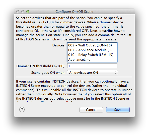

To create a scene, you just create a new device, select Scenes from the Type menu, select On/Off Scene from the model menu, and you'll see the configuration dialog:
Scenes Configuration Image
Select the devices you want to be in the scene (only dimmer and relay devices are available). To select multiple, hold down the command key and click the device in the list.
Next, you can specify a threshold for dimmer devices - when a device goes above the threshold, it will be considered ON, otherwise it's OFF.
Then you specify how the plugin will manage the ON state of the scene device. The two choices are:
  • All devices are ON - so the scene state will be set to ON when all devices in the scene are ON
  • Any device is ON - so the scene state will be set to ON when any of the devices in the scene are ON
Below the line is a special option for INSTEON devices. If you manually create a PowerLinc group with all the selected INSTEON devices in it, then you can check the Execute INSTEON Scene checkbox and enter the PowerLinc group number and rather than send individual ON/OFF commands when you tell the scene to turn ON/OFF, we'll instead send a group ON/OFF to the specified group This is very useful if you want all the lights in the scene to operate in unison.
